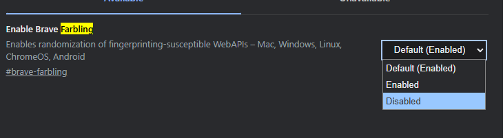

Devs have asked people to try some flags and provide feedback on whether you notice any changes. Only change one flag at a time.
They want to limit disabling the features to one at a time. So go in, disable the feature, then see if you get logged out as usual. If you do, then enable the flag again and disable the next one. Rinse and repeat until you make it through the list…assuming that none of them seem to resolve the problem.
Currently the flags are only available on Brave Beta or Brave Nightly . So you would have to install those if you don’t have them already. And if you haven’t already tested on Beta or Nightly, would be good to do that with the settings “as is” first.
brave://flags/#brave-domain-block-1pes
brave://flags/#brave-farbling
brave://flags/#brave-first-party-ephemeral-storage
brave://flags/#brave-provisional-tld-ephemeral-lifetime
Example:
Let’s say you disable brave://flags/#brave-farbling. You would restart the browser and test to see if you get signed out like you have been.
If it doesn’t work, you would put it back to Default and go to the next one on the list.
In regard to Beta and Nightly
If you hadn’t already been using or trying it, use it “as is” first before worrying about flags to see if the issue happens there.

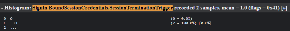

People with the problem, please keep brave://flags/#enable-bound-session-credentials enabled and on logout event please open brave://histograms/Signin.BoundSessionCredentials and dump everything you got on this page here. I’m mostly curious if anyone of you got Signin.BoundSessionCredentials.SessionTerminationTrigger histogram and what the value it has in this case.
The flag they mentioned is one that person said they disabled and the issue went away. But let’s not mess with that flag. The focus here is the Histogram for those of you being logged out.
I’d ask that you provide the Histogram data as a reply on the Github if possible. If you can’t or don’t want to do it there, advise and we can look at another way…maybe even just sharing here. Keep in mind you check the histogram thing right after you have a logout issue.
this is what mine looks like, is this enough info? if not, what else is needed to share without compromising my data/info since im sharing this publicly thanks
@blitzio yeah, I think that’s what he’s looking at. Main thing is to check that right when you see you’ve been logged out of Google.
@blitzio actually one of the others just posted. So it would show more. Such as:

And in that person’s list, you can see it shows Signin.BoundSessionCredentials.SessionTerminationTrigger in the list, which is what the dev was looking for.

There’s no sensitive data, @blitzio, don’t worry. It’s plain text and not very long, so you can easily verify that in a few seconds.
Check my other answer above to see how to post the information.
If you don’t have a GitHub login, you can put that here, and I’ll try to keep an eye out for that and post it myself on GitHub.
At worst, if you’re still wary about giving the information, give only the last item of my list, which is apparently the most interesting to them. It looks like this:
  • Histogram: Signin.BoundSessionCredentials.SessionTerminationTrigger recorded 2 samples, mean = 1.0 (flags = 0x41) [#]
    0 O (0 = 0.0%)
    1 --O (2 = 100.0%) {0.0%}
    2 …
So nothing sensitive or personal in it.
