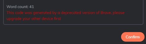

This is the “error” message that stops me from entering previously accepted code:
“This code was generated by a deprecated version of Brave, please upgrade your other device first”

Trying to enter the code used many times in the past, this is the first message:
When “confirm” is selected, this other message comes up:

@danielson
Yes, we changed the work of sync words, recently the time-limited sync words reached the Stable channel. And starting from the 1 Aug 2022 sync codes v1, which were not time-limited, are deprecated.
Now it is impossible to generate sync code words once and use it for a long time. The time limited sync code needs to be generated each time you are connecting a new device.

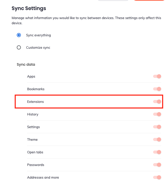

@danielson,
Extensions can still be Synced:
