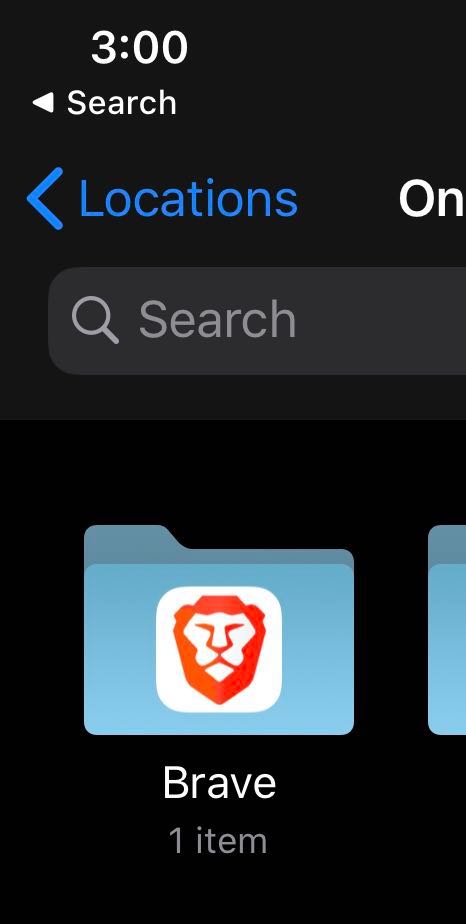

Do you happen to download a lot of files?
The best way to check this is through the native iOS Files app. If you go into that app you should see Brave, and a download’s folder there. See if you happen to have a lot of items:
Just for clarity – you can find the folder @anon1255531 Files --> Search [enter "brave"] --> Brave --> Downloads
Just checked it: I have not a single file in the downloads folder - not a surprise for me, as with my iPhone, I rarely download any docs.
Thanks,
Martin :slightly_smiling_face:
Hi Joel,
Thank you for the suggestion however I have does this and the folder is empty so I do not believe that this is the issue.
Is there something else that can be tried?
