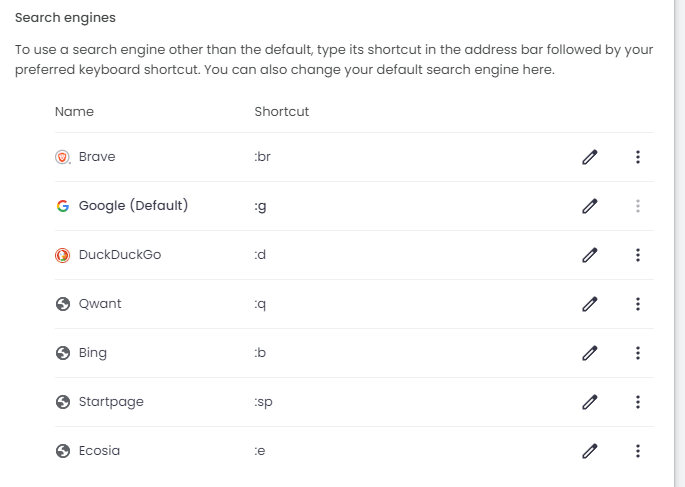

@GrdLock why don’t you try it? What you’re saying is incorrect. Yes, you’re right it’s listed under Site Search but that doesn’t mean it’s not a search engine or can’t be set as a default search engine. For example, below is where it shows Search Engines and Site Search. You’ll see that Yandex is listed under Site Search and not Search Engines.
However, as instructions have said, you click the three dots next to Yandex and you get options like:
Guess what happens if you click Make Default?
Now it has Yandex under Search Engines and it’s my default.
The links I provided explain some of these details. It’s always helpful to take the time to read through shared information and try the suggested steps before assuming or arguing. It can make everything much smoother for everyone.
