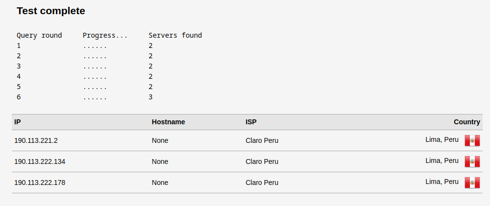

I still think there are good odds it is DNS related, it may be challenging to demonstrate but we can give it a shot.
If you go to https://dnsleaktest.com/ and run the ‘extended test’ in each browser, say Brave vs. Firefox, do you get different results?
In google chrome, where location roks ok:
In brave where it doesn’t:
In firefox, where location works:
En epiphany, where location also works:
Not sure what is a DNS leak, but the only browser where location does not work for me is brave.
Yup, got it, you explained that already. But the point here isn’t any ‘DNS leak’ itself, but to see if we can ferret out a difference in the way your DNS lookups are being performed. As I said, it’s going to be challenging unless you are able to review everything relevant directly on your end.
The way DNS-based geolocation normally works is an authoritative name server determines your location based on a client subnet as perceived by your DNS resolver, for example Google Public DNS. And it can then change the web servers you target based on that; this doesn’t necessarily translate into the web site serving you different content (i.e. a different map location in this case), but a different DNS resolver result would be an indirect means of showing that in Browser X you are seen as coming from a certain IP, whereas in Browser Y it’s a different IP.
Another thing we can look at is: https://whatismyipaddress.com/
You don’t have to tell us the exact IP result, but, is it the same across the browsers?
And, does it give the same geolocation problem as Google Maps?
Also providing a screenshot of brave://settings/security may help.

The what’s my IP site shows the same IP in all browsers.
