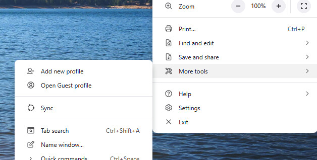

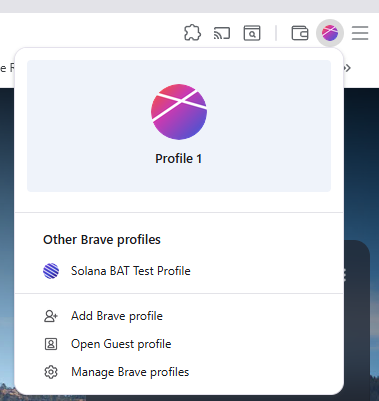

Are you talking about just the normal browser profiles? If so then you can think of those as kind of accounts for the browser. Each of the profiles would keep history, bookmarks, passwords, and some of the basic settings all separately. The only thing is they are not password protected or have any particular logins so it would just be an easy matter of switching. But it could be good like if you wanted a personal profile that would be all your personal accounts and then maybe another for your like work or school. Or of course if you could have one profile for yourself and another for a relative that’s using your device.
Just to stress that again though is that each profile would not be kept private or secured from anyone on the device and is easily swapped to. It’s just a way of sorting those types of information or settings for convenience.
This exists on just about every single browser that exists. Whether you’re talking about Firefox, Brave, Chrome, Microsoft Edge, or whatever. Well, at least on desktop.
Is there anything in particular you’re trying to figure out with it? I mean in general it’s just the idea of creating a new profile via the hamburger menu if you want to create one and then it’s just clicking on the icon and tapping on it to switch.

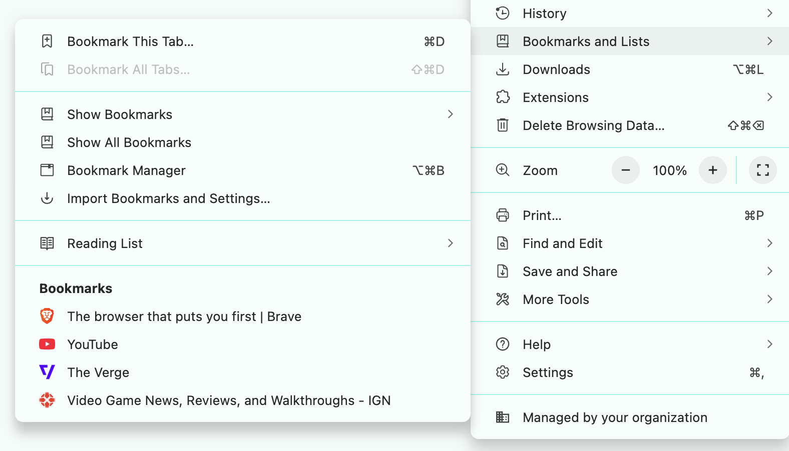

@Saoiray Thanks. At the moment my interest in Profiles concerns seeing whether problems experienced in the default Profile are absent from a comparison Profile (based on a suggestion from @Mattches in another post).
Going by what’s displayed in the Bookmarks dropdown, it appears that switching to a pre-existing Profile brings in all the bookmarks that were either created or imported into that Profile – i.e., they now also display in both Profiles’ Bookmarks dropdown.
Is there a way to keep bookmarks in their own Profiles so they don’t display in other Profiles?
And now that I’ve got them displaying in both Profiles, how do I get rid of the ones that were brought in via the comparison Profile so I only see the original bookmarks (the ones that were in the default Profile) in the Bookmarks dropdown?

@Saoiray Now I’m the one who’s confused. All I meant to communicate was that when I switched to Profile 2 (just to test some issues that were occurring in Profile 1), after returning to Profile 1 I noticed in the Bookmarks dropdown menu at the top of the page that I was seeing not only the bookmarks in Profile 1 but also a whole slew of other bookmarks. All of those bookmarks are very old and I don’t have any use for them currently. So my question was how to get back to the bookmarks display I originally had in Profile 1 – i.e., only the bookmarks in that Profile.
@mattches Please see my reply to @Saoiray. The dropdown is the menu of bookmarks that displays when ‘Bookmarks’ (at the top of the screen) is clicked on.
Switching to Profile 2 – at least I think that’s what caused it – brought in a lot of bookmarks that I don’t need or want. These were added to the bookmarks in Profile 1. I would have expected just to see the bookmarks ‘attached’ to Profile 1 when in that profile.

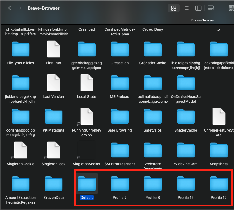

When you originally installed Brave Browser, the initial (aka default) BB user profile name is “Profile 1” and that BB user’s data is stored in the Default folder:
/Users/yourusername/Library/Application Support/BraveSoftware/Brave-Browser/Default/
When you created the 1st additional BB user, that BB user profile name is typically “Profile 2” and that BB user’s data is stored in the Profile 1 folder:
/Users/yourusername/Library/Application Support/BraveSoftware/Brave-Browser/Profile 1/
When you created the 2nd additional BB user, that BB user profile name is typically “Profile 3” and that BB user’s data is stored in the Profile 2 folder:
/Users/yourusername/Library/Application Support/BraveSoftware/Brave-Browser/Profile 2/
The Bookmarks files are in JSON format. On the Mac, you may safely examine the contents of a backed up Bookmarks file, by using a JSON viewer, such as the OK JSON app (‘https://apps.apple.com/us/app/ok-json-viewer-formatter/id1576121509?mt=12’).
BTW, you could open all three of the BB user profiles folders, and arrange the windows so that you can observe the Modification Date of each Bookmarks file.
Then, you could use a BB user profile and create a new bookmark, and observe if the Modification Date of that BB user profile’s Bookmarks file changes (it should) . . . but the Modification Date for the other 2 BB user profiles’s Bookmarks files should NOT change.
You could test that process, for each of your 3 BB user profiles.

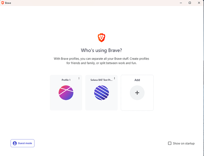

Profile name = what the profile is called when you go to open it in the browser – for example, in this image, I’ve created several dummy profiles with names like Test 1, Test 2, etc:
Profile folder/directory = This is what you see when you go to your User Data folder (~/Library/Application Support/BraveSoftware/Brave-browser\) and look at your profile data. Your “main” profile (the first profile created when you install and launch the browser) should be called Default.
Each additional profile created after this will be called Profile x where “x” is the number of additional profiles you’ve created. So for example if you create 2 additional profiles, you’ll have a Default folder, then Profile 1 and Profile 2. If you then go and delete Profile 1 and Profile 2, then open the browser and create two more profiles, you’ll then have your Default folder, as well as Profile 3 and Profile 4.
I have created and deleted several profiles on this particular Brave instance, so my numbers are a bit wonky, but follow the same conventions:
@mk7z If you only have two and have only ever made two, then when you look in there, you should see a Default profile folder and a Profile 1 folder.

No, apologies for the confusion. The Brave-Browser folder is your user data folder. So you should see your Default folder, which you did in Brave-browser – do you see any folders named Profile [x] where x is a number?
