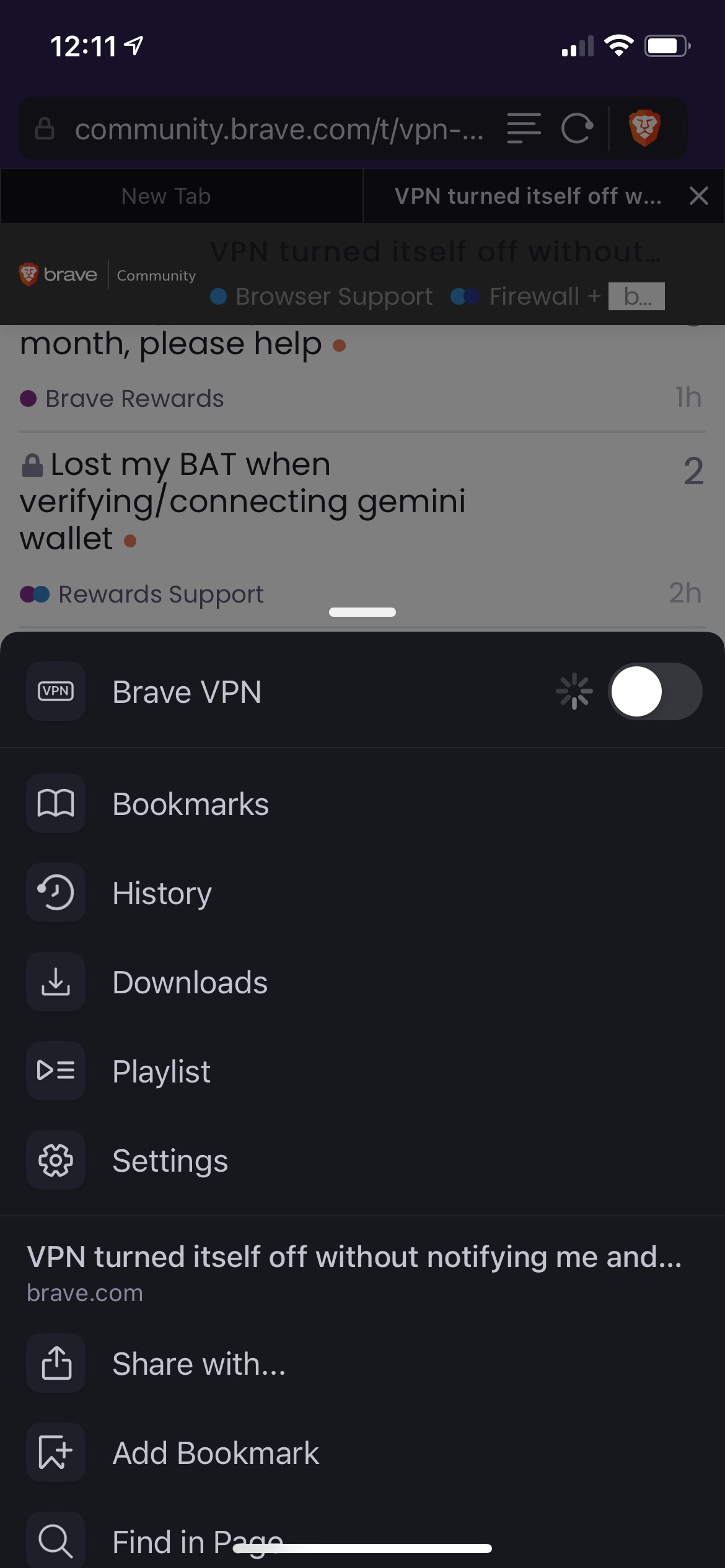

After reinstalling Brave 1.32.3 my VPN issue has returned. When I go to firewall + VPN settings and try to enable the VPN, it still shows up as disabled in Settings.
When I try to enable the VPN from the “…” menu the spinner spins forever.
What should I do? Do I need to reinstall Brave again?

When I try to enable it from that screen the switch goes to “On” but there’s no pop up. It looks like this.
If I go back to the main settings menu and return to this screen, the switch has reverted to “Off.”
