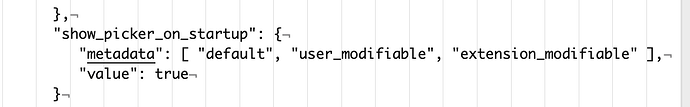

There should be a selection - “Show on startup” - also in that window (your screenshot):
. . . but that checkbox does not show?! In a Brave Browser New Window, go to ‘brave://local-state/’ and search for “show_picker_on_startup”
What is the “value” for that: “true” or “false” ? (You must not try to edit what you see in that window.)

The Show on startup option does appear afaik. Just checked on macOS and Windows:
i don’t have that, so it’s probably off. I can’t access it because after 2-3 seconds it automatically closes, as cold turkey doesn’t detect an extension, even if I click on the “work” profile.
