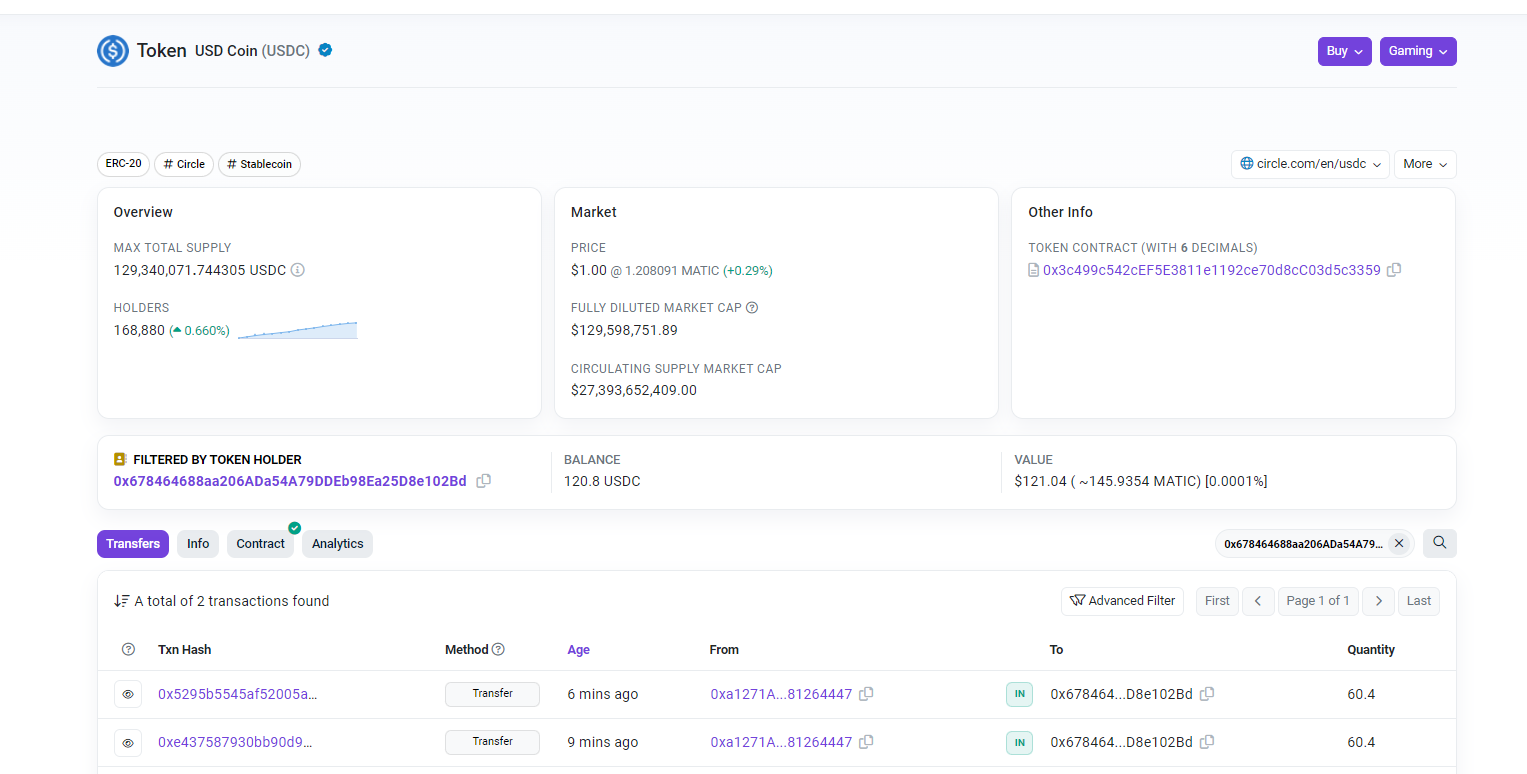

I believe I added the proper token onto the wallet, after I made the purchase and it still shows nothing, and here is the Matic site where it shows the confirmation and that it was sent to my brave wallet. I think where I screwed up is that on Transak, when I purchased the token the wallet auto-filled with the one from Brave wallet as normal, but I think that address is Eth only? I added screenshots for further help!
Try adding this USDC contract manually, instead of the USD Coin (PoS) option shown in the pic above.
Network: Polygon
Contract: 0x3c499c542cEF5E3811e1192ce70d8cC03d5c3359
Token Name: USDC
Symbol: USDC
Decimals: 6
Let me know if that works instead. Thanks!
OMG! That worked, Evan you’re a goat, thanks for the help brotha!
