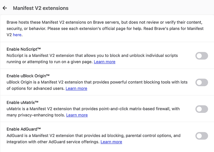

Microsoft Edge is using uBlock Origin. I would want to know if Brave Browser has the Manifest V2 uBlock Origin extension Enabled?
brave://settings/extensions/v2
And, I would compare the Developer Tools > Network windows and Console messages.
Extension is the same, ad blocking using build in brave, in edge ublockorigin, same content, and switch to use edge for rest of the time and yes usage of memory consumption in edge way better than in brave one to one content, did not use manifest extensions in brave
