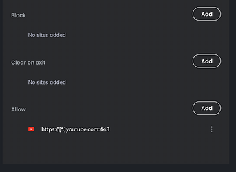

I don’t think this does what I need because as far as I can tell it deletes ALL cookies (and the other items) but I want to keep certain selected cookies (set up via Cookies > Allow).
@Fellwalker57,
If you add a website to the list of allowed cookies, it should persist through the Clear browsing data process:
Test by adding a site or two to this list, setting your [On Exit] tab in Clear browsing data window to clear cookies (and/or anything else you want), save, then close/relaunch the browser. Return to brave://settings/siteData and check to see if cookies are preserved correctly.
I’ve tried this before and it deletes all cookies. This is safe but it makes for a lot of work as the sites whose cookies I wish to preserve go to some lengths to get me to prove my identity when their cookie has been removed.
@Fellwalker57,
Can you ensure that you’re using the appropriate format when entering URLs the sites with cookies = Allowed? Note that due to a particular issue with pattern matching, cookies/site URLs must be entered in the specified format: https://[*.]website.com/:443
Subtle! I use [*.] always but I was unaware of the :443 requirement. Will try and report back.
This did not work. All cookies, local storage etc. was deleted on exit.
