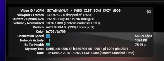

Another thing you can try, I believe on Mobile YouTube (been a while since I accessed mobile YouTube from a browser and not used the official app, yea I suffer through the ads I don’t know why, lol) you should have an option for “Stats for nerds” as well. When it freezes if you can get a screenshot of that stats for nerds text it would actually be great.
(Screenshot from PC, but the look of this usually is the same across platforms, it tells us everything about YouTube’s player and how it’s being fed the video over the network, decoded, etc).
