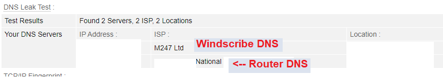

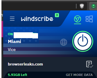

  1. Activate a VPN extension (example used here: Windscribe but i tested with Avira Phanton too)
  1. Visit http://www.whatsmydnsserver.com/ or https://browserleaks.com/ip
  2. Check DNS servers
  3. The VPN provider DNS appears along with my router DNS and the secure DNS config from above (Cloudflare).
The DNS tests should show only the private DNS or the VPN provider DNS in each situation.
