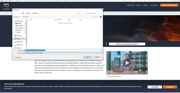

I was able to replicate it again, this time it froze the entire application… See the screenshot below… it looks like its normal, but in fact its completely frozen and i cant click on anything, i end up having to kill it via task manager… Unfortunately, again its not in the Crashes though.
So also, i was just trying to attach the screenshot in this message, and it popped up with the Open window to attach, and it froze on there also… see both screenshots below:
Hi Luke,
Ah ok - so you’re not experiencing an application crash it seems; program must just be hanging or is deadlocked. Even with crash reporting off, it would show some entries (just not sending them). Maybe if you let it hang long enough a crash will actually happen?
