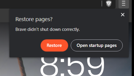

Brave does not close properly
  1. I always close Brave using the close button on the top right.
  2. Lately, even though I closed Brave correctly, when I launch Brave, it claims it did NOT close properly and asks if I want to restore.
**Brave Version 1.2.42
Windows 10 Home 1909
