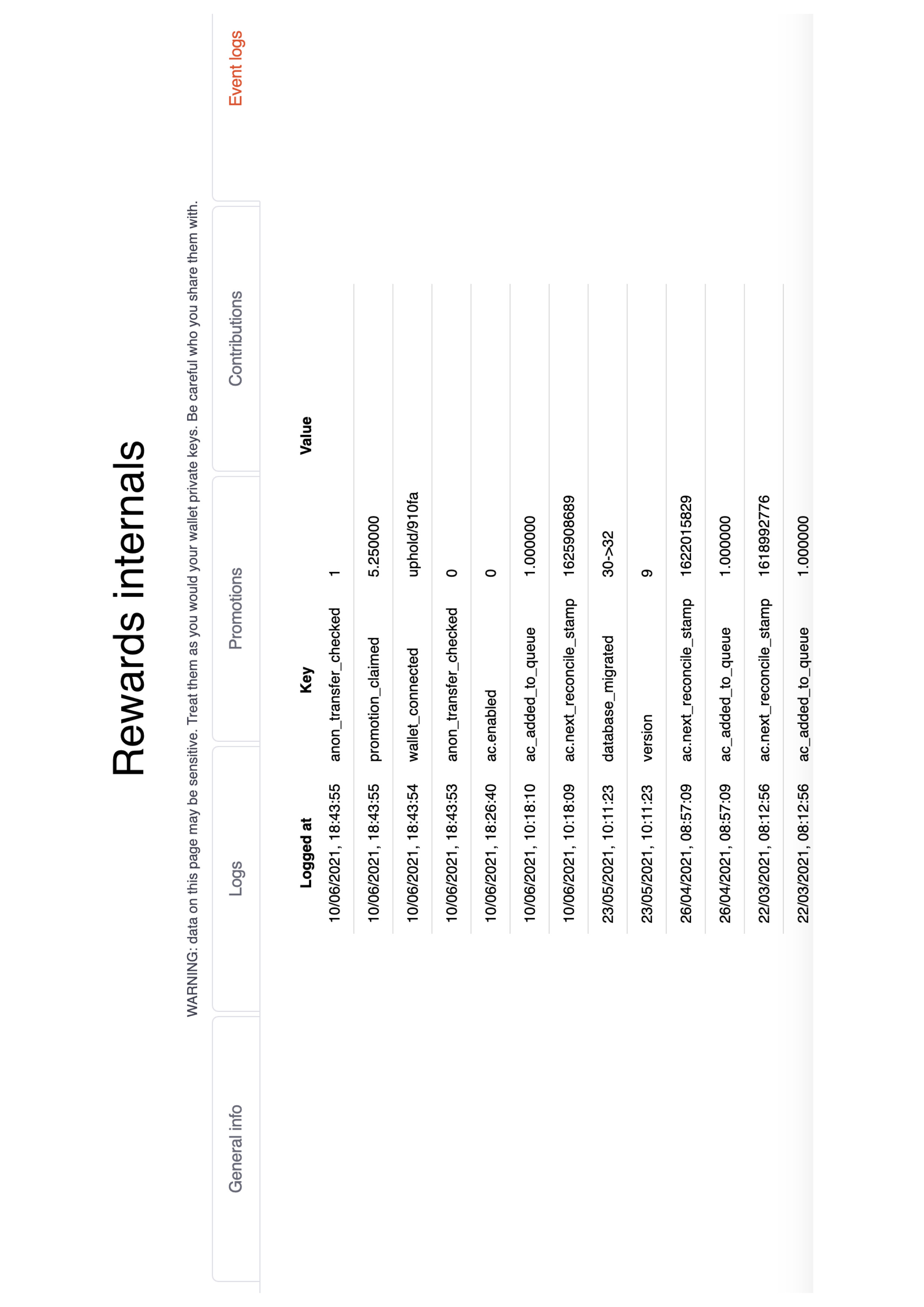

Just checked my rewards and somehow my auto-contribute was on while i never turned it on (I don’t earn enough to do it! Point in case, June has me at 0.500 BAT while I somehow have auto-contributed 1 BAT!
Please advise how this could happen and how we can cancel this.

Thanks for reporting. I’d like to ask a few questions to start:
- Auto Contribute is ON by default and must be manually turned OFF. Did you turn it OFF?
- Do you have multiple devices linked to your Uphold? If so, is Auto Contribute turned OFF on each of these devices?
- Can you share a screenshot of your Contributions and Event Log tabs which can be found here brave://rewards-internals/
Thank you in advance!

See below the reply and attached the screenshots.

Yes, I did, had checked before.
No only just managed to get the Uphold verified as was hard with the Brave security turned on!
See attached.
