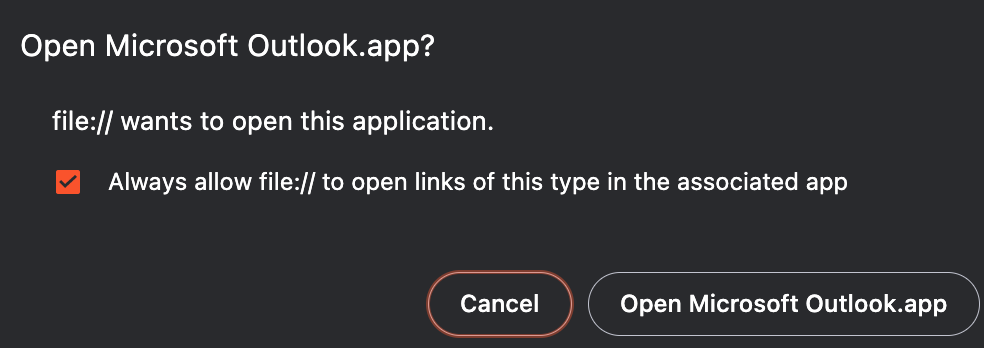

Always allow website.domain.net to open links of this type in the associated app does not work*
  1. Set Microsoft Outlook as the default email on the Mail app.
  2. Click on any email address or mailto link on Brave V1.26.74 on website.domain.net
  3. Check the always allow box and Click “Open Microsoft Outlook.app”
  4. Reload the webpage or quit and open the webpage website.domain.net, and then click on the email address or mailto link. The same prompt “Open Microsoft Outlook.app” appears again.
Brave should have opened outlook without the prompt:
**Brave Version( check About Brave): V1.26.74

I even tried creating a test HTML file:
Test Web Page!
Testing outlook on brave
Send Email
Opened it using Brave
file:///Users/voldemort/Downloads/test.html
Clicked the send email mailto link
Clicked always allow and opened outlook
Clicked the link again. Same problem.
