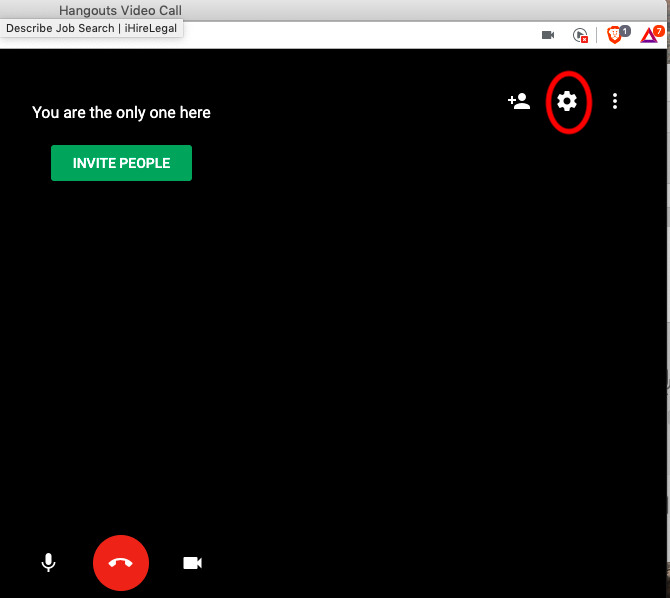

I’m not running the same versions as you (macOS Mojave 10.14.4 on slightly newer Air 13, Brave 0.67.2 Chromium: 74.0.3729.131 (Official Build) nightly (64-bit)), so my result may not be terribly valuable, but Hangouts gets my mic just fine. Since you also don’t have trouble with your Mojave, this suggests it could be an OS problem. Either way, you say you made sure Hangouts had access to the mic and camera, but it’s not clear whether you confirmed they are both selected. It’s also not clear whether the person on the other end can see you. Couple things to check, though, that might help (you probably already did them, but just in case):
  1. The Sound Preferences of macOS itself to be sure the microphone you want to use is selected as input device and that its gain (Input volume) is turned up enough to pick your voice up (image of Mojave Sound panel, click image to embiggen).
  2. Hangouts Preferences once the call is going. The gear in upper right if clicked opens the settings/preferences for the call. Select input device if not already selected.
If that doesn’t do it, maybe try turning shields off for hangouts (click the lion icon in the address bar to call that up). Maybe someone who still has High Sierra on a Mac can try, too.
