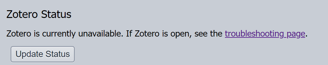

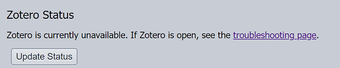

The error message (the Zotero program was running when this occured:
The Zotero Connector Plugin interface doesn’t see Zotero anymore. Here’s the plugin’s settings page:
Zotero captures the reference in the main program
