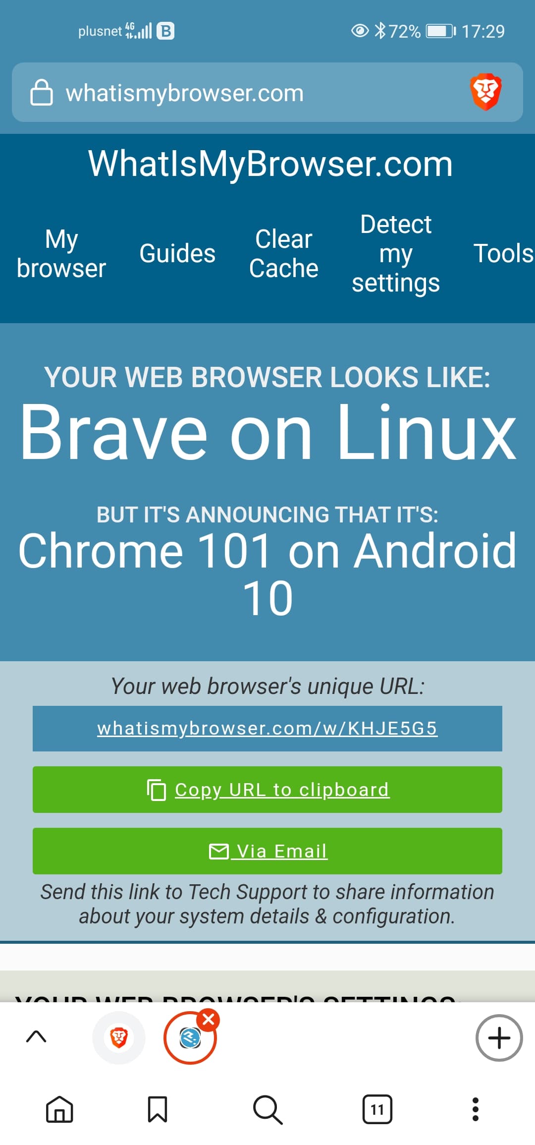

Interesting. I tried the site and
So both half right as is Brave on Android 10.

Hi, just ran across this post. I get this when I use the “whatismybrowser” site.

Beta version whatismybrowser results :
Also just noticed that the whatismybrowser website says:
which is odd as Brave settings say that third party cookies are not enabled.
Is that something to worry about or is Brave doing something clever?
Do you have block scripts disabled on the shield icon? Mine is on and what the site shows is below. When I disable, it shows the same as yours.
Useragent isn’t the only method of detection. you can add the following whatismybrowser.com##+js(brave-fix) add into brave://adblock to counter the Brave check,
I do/did have scripts not blocked. I have and now it says no to javascript and both cookies could not be detected. But why did it still think 3rd party cookies enabled before when they were specifically turned off.?
I really don’t know. I am not very tech savvy. It does seem the third-party cookies should be disabled even if user does disable scripts blocked. I do not know if the result displayed is as it should be or not. Maybe has something to do with this Brave GitHub issue report?
The site is going by probabilities based on parsing the headers + some additional stuff using scripts. It cannot detect directly what your settings might be.
