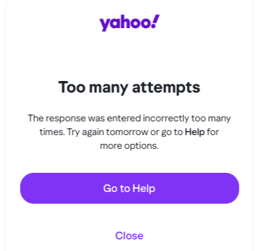

The sequence I have to undergo each time I try to log in to Yahoo! Mail is basically the following (screenshots available if desired, one included below), sometimes with slight variations:
After entering my login ID I have to go through several CAPTCHAs.
Even if I clearly get the first CAPTCHA right (whether bicycles, cars, fire hydrants, crosswalks, etc.), others follow, sometimes with ‘try again’, indicating that Yahoo! (or Google) thinks I didn’t get it right.
When Yahoo! finally seems to have decided I’m okay and it looks like I’m finally gong to ‘get in’, it puts the following on-screen:
Note “Try again tomorrow”. Sure. And the “Help” link is just an on-ramp to paid support.
If I start over, I may or may not be successful getting in on the second try. If not, there’s nothing I can do, except go to Safari, where none of the foregoing occurs.

@mk7z I was only pointing out the other user’s issue because in order to investigate it I had to log into yahoo! mail and I did so without issue.
If you’re connected to a VPN when you see this issue, that may be the cause at least for the captchas. I would also recommend, if you haven’t already, clearing cache/site data for the site. You might also want to test in a fresh profile.
I would also be interested to know if other Chromium-based browsers (which Safari is not) show the same behavior.
