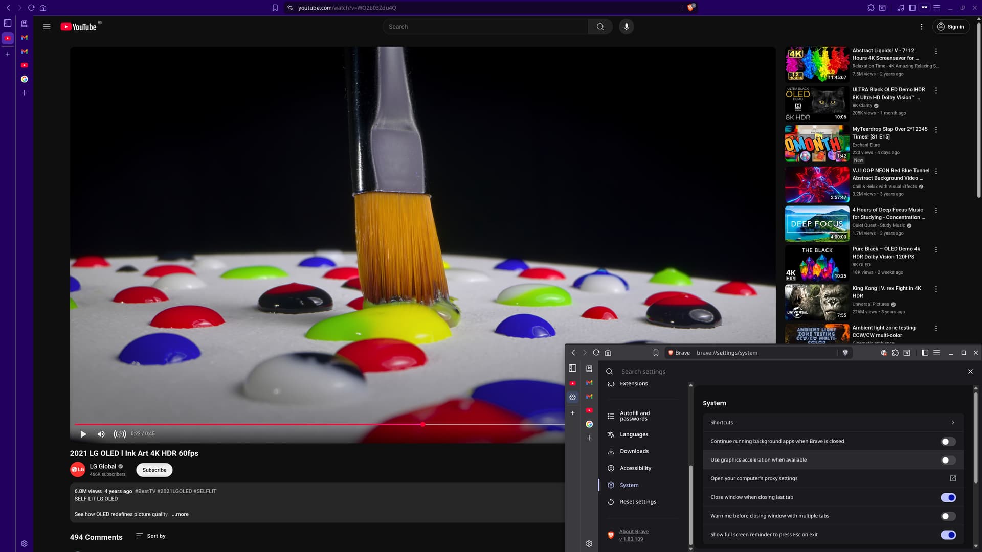

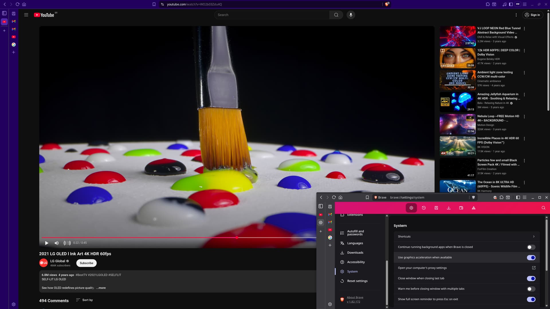

Screenshots:
  1. Hardware Acceleration ON – Brave 1.83.109
  2. Hardware Acceleration OFF – Brave 1.83.109
  3. Hardware Acceleration ON – Brave 1.82.172
It may be hard to see but it is specially noticeable in black portions of the screen as black appears grey. It also affects the elements of the browser itself eg. the purple of the private tab.

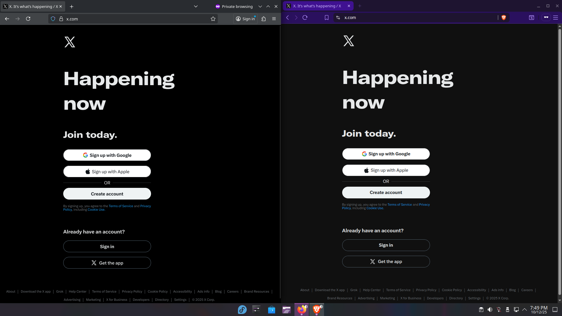

hey, I have the same issue.
I think that this issue started appearing after chromium merged support for HDR on Wayland.
Something interesting I’ve noticed is that I only have this issue on KDE Plasma Wayland, I don’t have this issue on Cosmic or GNOME, where even if I have hardware acceleration turned on, colors are not washed out, so this makes me believe that it might be a KDE issue.
This is what it looks like right now on KDE Plasma with hardware acceleration on:
I’ve opened a bug report to the KDE Plasma bugzilla because this seems to happen only on Plasma and not other Wayland desktops like GNOME or COSMIC.
