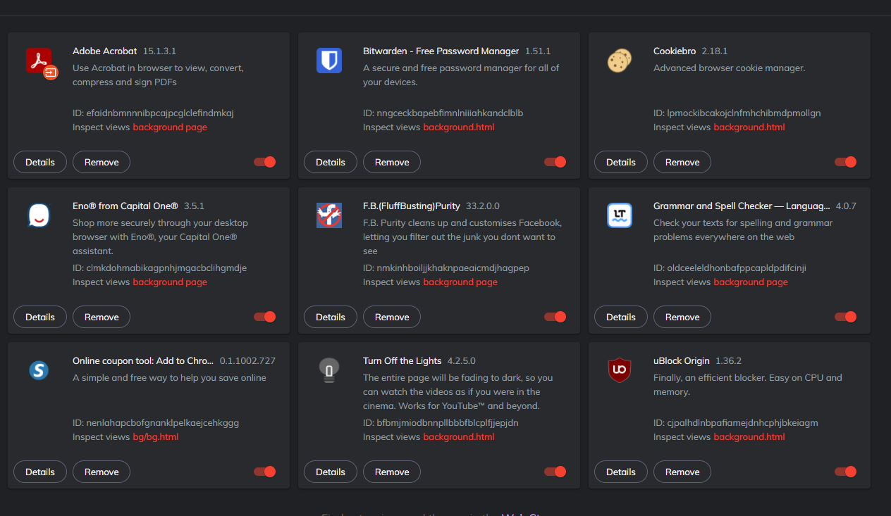

I think this because one of the Extensions
Check for extensions here: brave://extensions and upload a screenshot over here for me to look for.
Thanks!
I can’t really see a specific extension which could be a problem… Before trying to find it, can you disable all the extensions and see if that Warning still shows up?
It will suggest if there is problem in the extensions or if its a completely different problem…
Sure, I’ll disable all and see if warnings still shows. I’ll let you know.

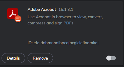

One thing I noticed is the event log is showing this extention ID: Corruption detected in extension eoceebklhjepohnakemchinmkdpbolgh
If I disable an extension, it shows the extention ID. However, none of my extensions are matching this ID.
Example:
