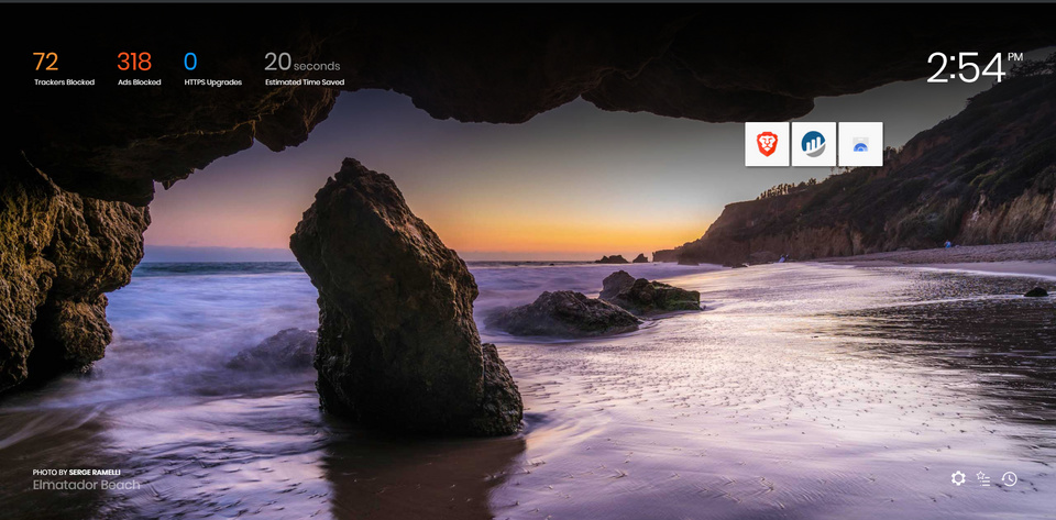

The closest to an older build that I have is a VM last fired up on 1/7/2026, so I checked there (with the VM’s net adapter disconnected to it can’t update). (Brave version 1.85.120)
I cannot at least on that build, see any speed dial on a Private Window:
Since we have “offline installers” available on GitHub, if OP is willing to provide a version number where they know they saw speed dial, we can install that offline version (with the net adapter still disabled so it doesn’t auto-update itself) and then re-verify.
But with that said, I swear I’ve never seen a speed dial in a Private Window, because it’s “private” therefore it wouldn’t be private if it had a speed dial (since it’s using its own NTP specifically for private browsing, which doesn’t even show you time, news, or stats, not even settings since it wouldn’t be persistent anyway).
