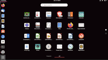

I’m thinking I should switch to mint because Ubuntu really doesn’t seem as good as Mint. I don’t for example have that screen.
If you’re just starting with Ubuntu, maybe change before you have a lot invested in it, @jubilee, but Ubuntu is fine. Note that Mint is based on Ubuntu, so in many ways they are very similar. I used Ubuntu off and on from version 4 to version 16 and beyond, with a laptop using it full time from version 9 to version 11. I’ve also had Mint installs going off and on since version 17 or so, native and virtual. Other distros, too. I tinker.
I set up a virtual machine using Ubuntu 19.1. It looks like Ubuntu’s handling things a little different from Mint is all; the settings we want in this case are in Software & Update instead of Software Sources. There are two things to check: repository entry and authentication of the repository.
