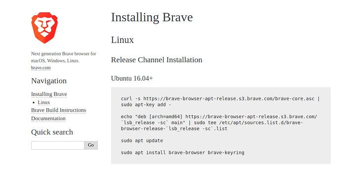

Hello @raincitycode. That was probably my comment about curl. That is a problem if you do a minimal install on Ubuntu 18.04 and try to install Brave . I am assuming you are trying to install the now depreciated Moun version 0.26.xx from the software center. I believe the snap is still available in the Software center. You should be installing the new Brave that can be found here;
https://brave-browser.readthedocs.io/en/latest/installing-brave.html#linux
Open a terminal and copy and paste the 4 commands in sequence . As pictured here.
This should have going on my favorite 18.04 +Brave.
Yes, I was trying to update via Terminal. Thank you! It worked. Removed via ubunut’s software center and installed the new one.
