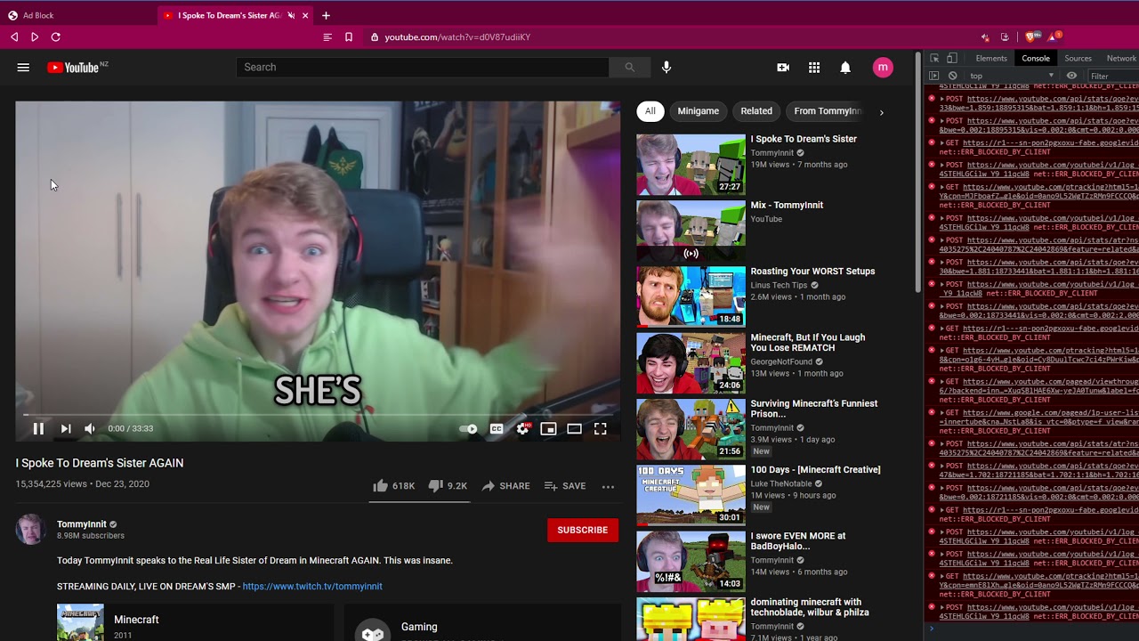

I was testing some youtube playback (via a Indian VPN, ~4mins) https://www.youtube.com/watch?v=pAPS8Vc9-xw
Didn’t see any pre-rolls, from clicking on any videos or letting the video playthrough to the next.
What is the best way to replicate it? @pinaxx
Also tested caching (using back/forwards) in Brave Beta build, near clean profile.
Testing some test filters in brave://adblock , if anyone wants to test out.
youtube.com,youtube-nocookie.com##+js(json-prune, *.playerResponse.adPlacements)
youtube.com,youtube-nocookie.com##+js(json-prune, *.playerResponse.playerAds)
  • Open/install a clean Brave Beta Profile
  • Add the filters into brave://adblock
  • Login to youtube.com
Then test :slight_smile: Let me know how it goes
