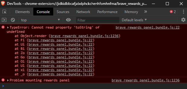

I search a bit, and found this :
When I right click behind the Brave’s symbole and inspect (cdd
And I saw this :
Might it be the problem ?

I think the issue everyone here is running to is already known and logged:
I know that this issue references Nightly specificially but the fix isn’t limited to Nightly builds. It seems that the fix has been uplifted to 0.69x releases, meaning that you should see it reflected in the next browser update.
I apologize for the inconvenience.
