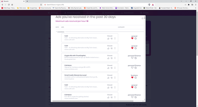

Okay, so assuming Focus Assist and all is off and you have Notifications on, I guess the other thing to check is your 30-day Ads History you can access from brave://rewards/.
It should pull up a menu like you see in my screenshot below.
Basically it shows all ads you’ve seen and whether you’ve viewed them. Now just FYI, where I have some with :heart: and all, that’s not important. The thumbs up or thumbs down is your rating for a particular ad, which is just feedback to the advertiser but has no influence on your earnings. The :heart: is to show that you like/prefer ads from that category. And the :no_entry_sign: icon is one you never want to hit, as that tells Brave not to show you any ads from that category.
If you’re seeing ads listed but they show something like Dismissed or any term other than Viewed, then you have something interfering. Also, by looking, you can kind of see how many ads you’re seeing in a day.
