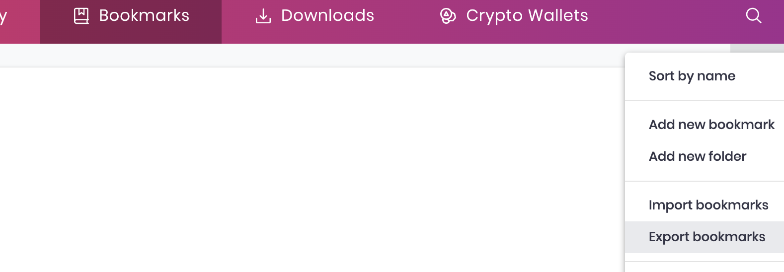

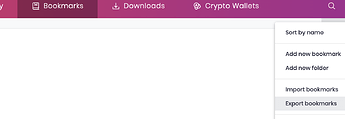

Yes there is import/export, if you go to brave://settings/passwords, you can export all passwords.
