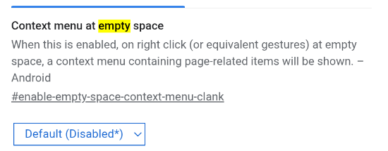

Back then I did find that if you enabled #enable-empty-space-context-menu-clank in brave://flags then the issue occurred as you see. But the fix should have resolved. You could always go to Disable that.

You may need to change that flag yourself for now and disable it, as you see in this screenshot

yes. You are right. Thank you. But why ist enabled as default on my tablet?
On my phone its disabled as default.
:folded_hands:
That flag was controlled via griffin study and changed the default value to Disabled till chromium 140. 1.82.166 switched it back to Default already and upstream should have fixed it by that point. It happened mostly on Samsung devices and we don’t see the issue there already. But it looks like some devices are still affected. I checked and upstream also have it Default already, hopefully they fix it soon.
