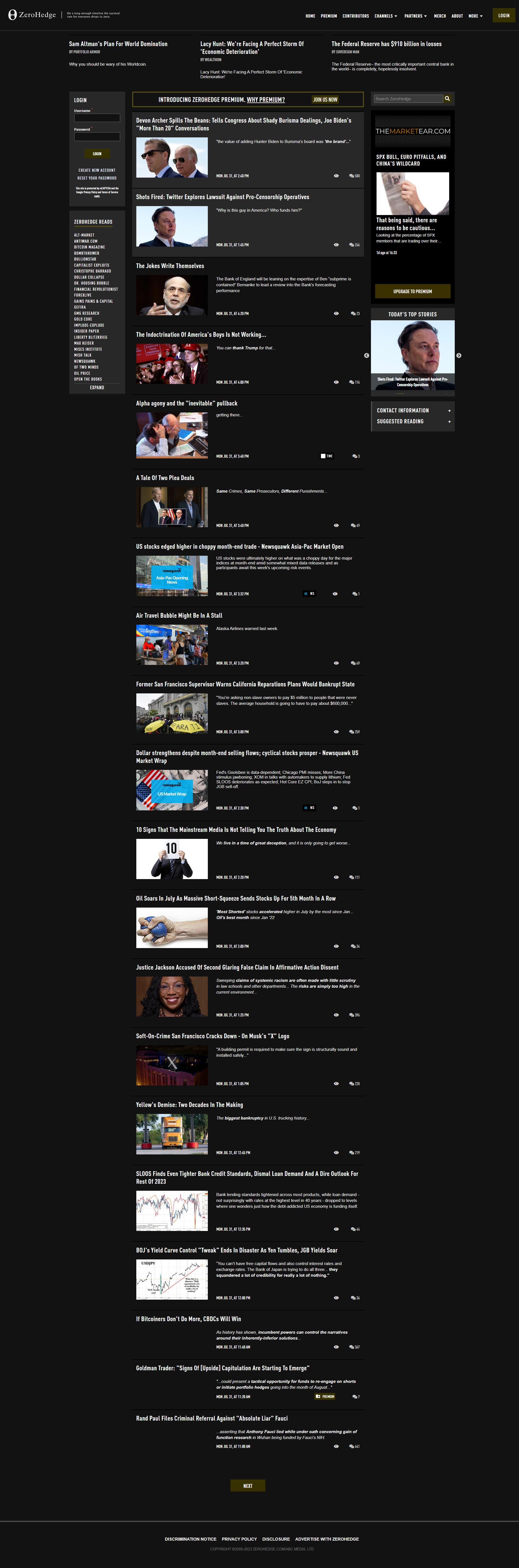

For example, this is how the website looks on my side.

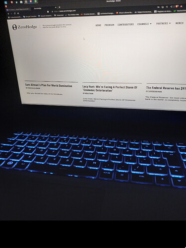

Please find the attachment. It’s the best I could do to show how different the site appears now. This is all way above my pay grade. When I screen printed, it looked the way the site should, very frustrating. Makes me look like a liar. All other sites look normal. Some how, the changes I made stuck. Shame on me for playing where I shouldn’t. This is the first email from my phone. Slow as mud. I’m thinking I’m borked here. I appreciate your time and knowledge, there were great links to learn from you supplied. I’m too old for all this with many other things to attend to. Many thanks, cheers.

I mean, it looks fine on Windows, and you said it was okay before, so there should be an explanation about this. but it wasn’t Devtools if you for example restarted the browser and all that, but looks like the sidebars are gone and maybe somehow the images were blocked or something.
So better check permissions first, since it could be anything there and the adblocker which is the only way to truly block everything and make changes to the page.

This is what I mean you should look forward, this is how it looks in a clean profile with only the Block Cookie notices setting on:

A screenshot like the one I provided could help, because it’s something inside the adblock page.
