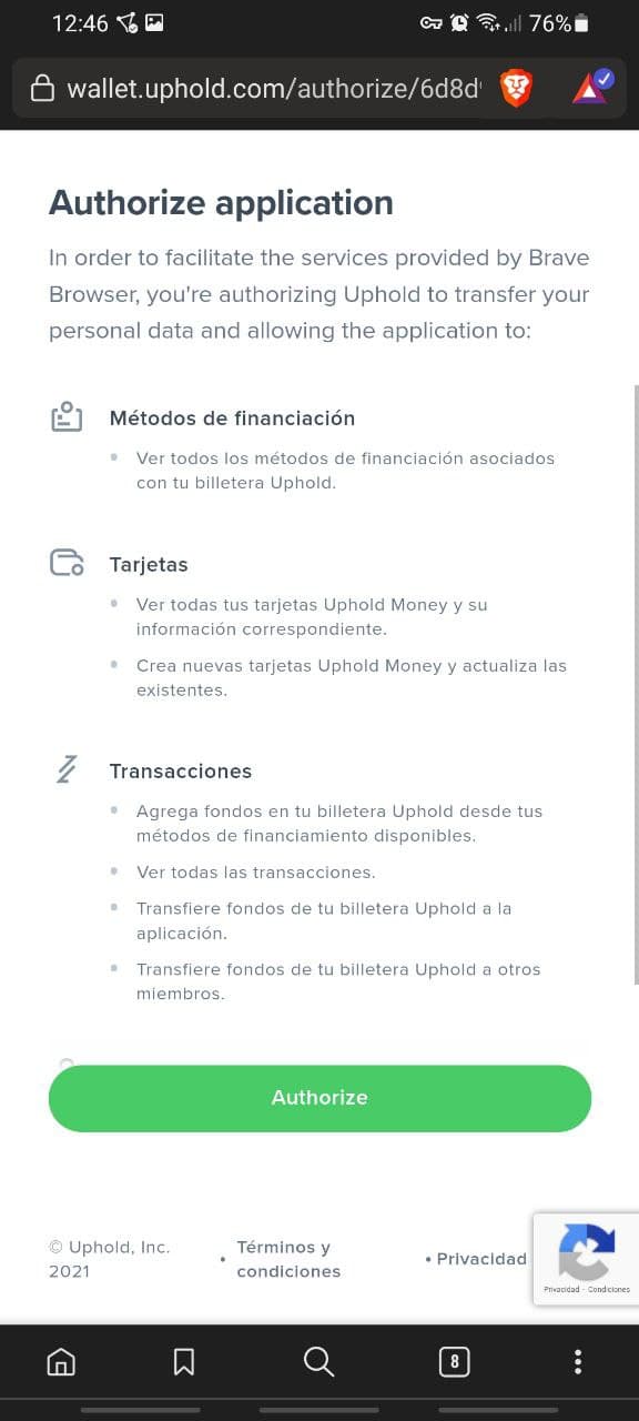

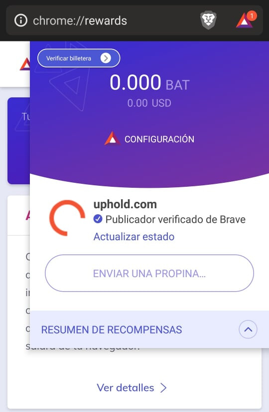

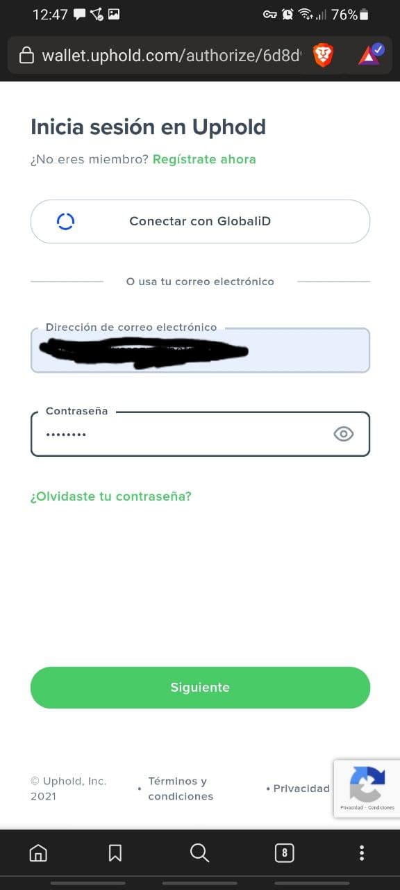

Same issue in Android Ver 11.
Browser attemp to login on Uphold and after authorize return to the Rewards page and the Uphold account is no longer verified.
Same thing happening on my android phone and tablet.
That is what I get after I go through the verify wallet process.

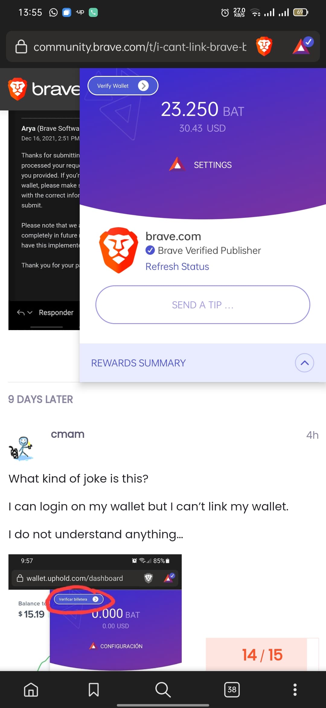

I can login on my wallet but I can’t link my wallet.

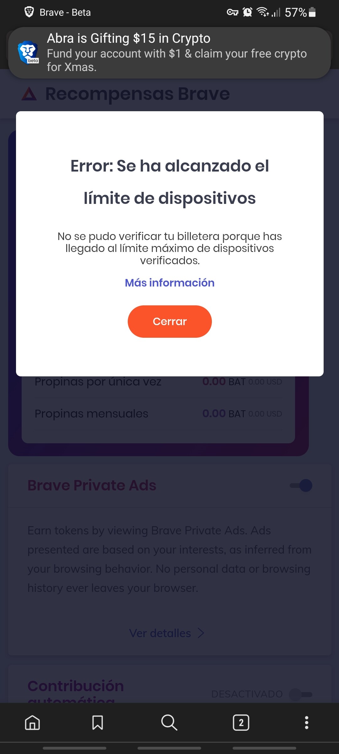

Today I update my Android Brave Beta (I already installed in Android Beta-Nightly-Stable versions) and now look different the rewards section.
And say that only 2 BAT enough to link my uphold account.

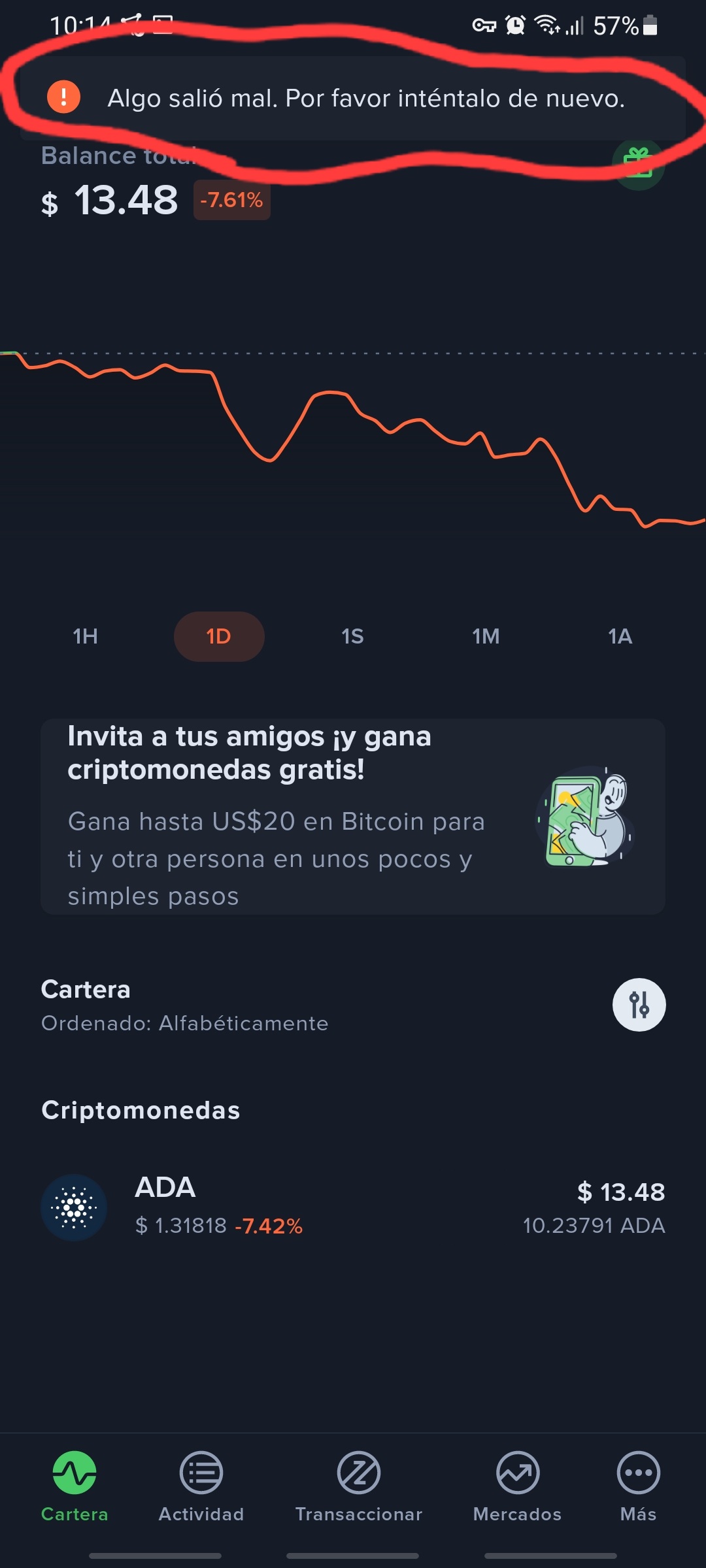

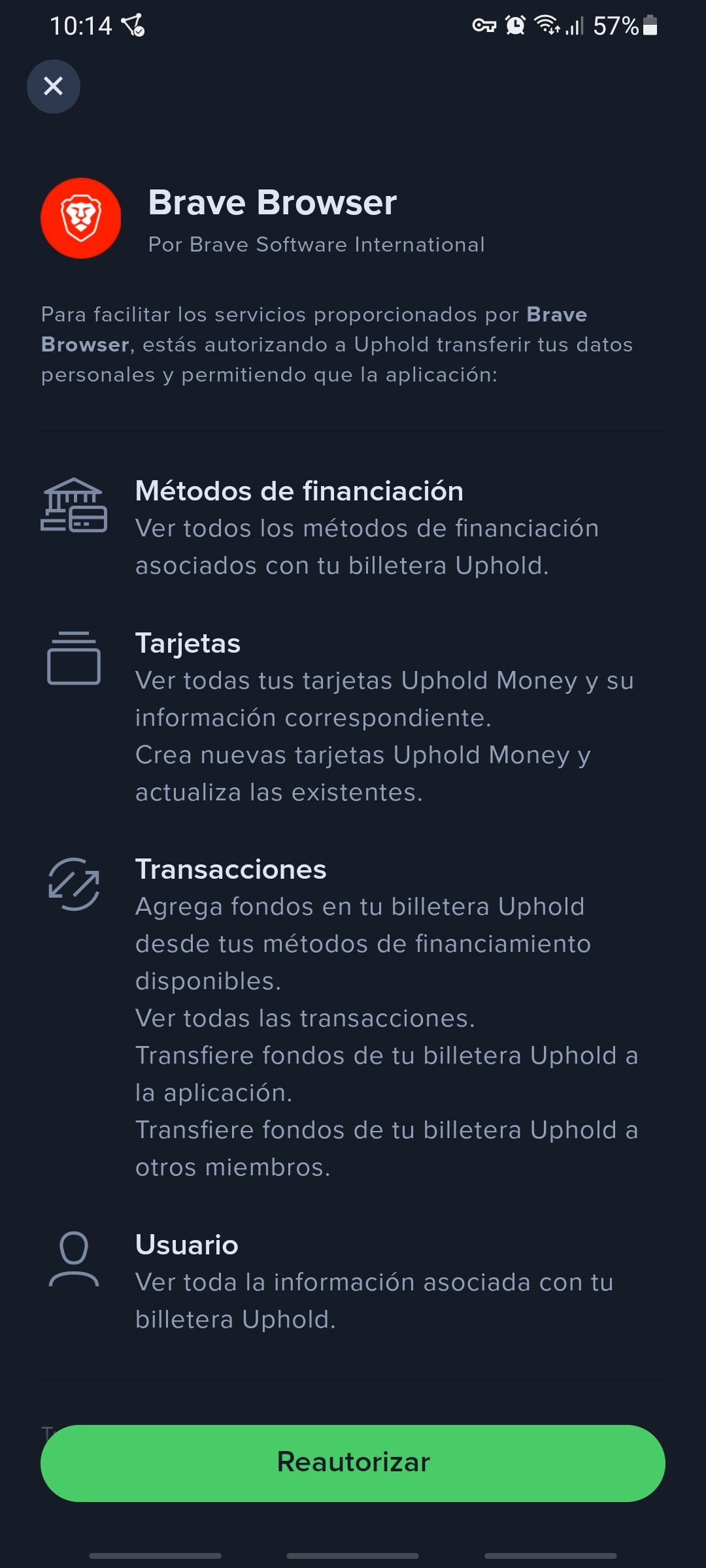

But, I try to connect to uphold, then open Uphold app and say that something is wrong.
Uninstall Uphold app to try login on web and say that I reach the devices limit.
Please help me. I need to link my 3 Brave versions.
