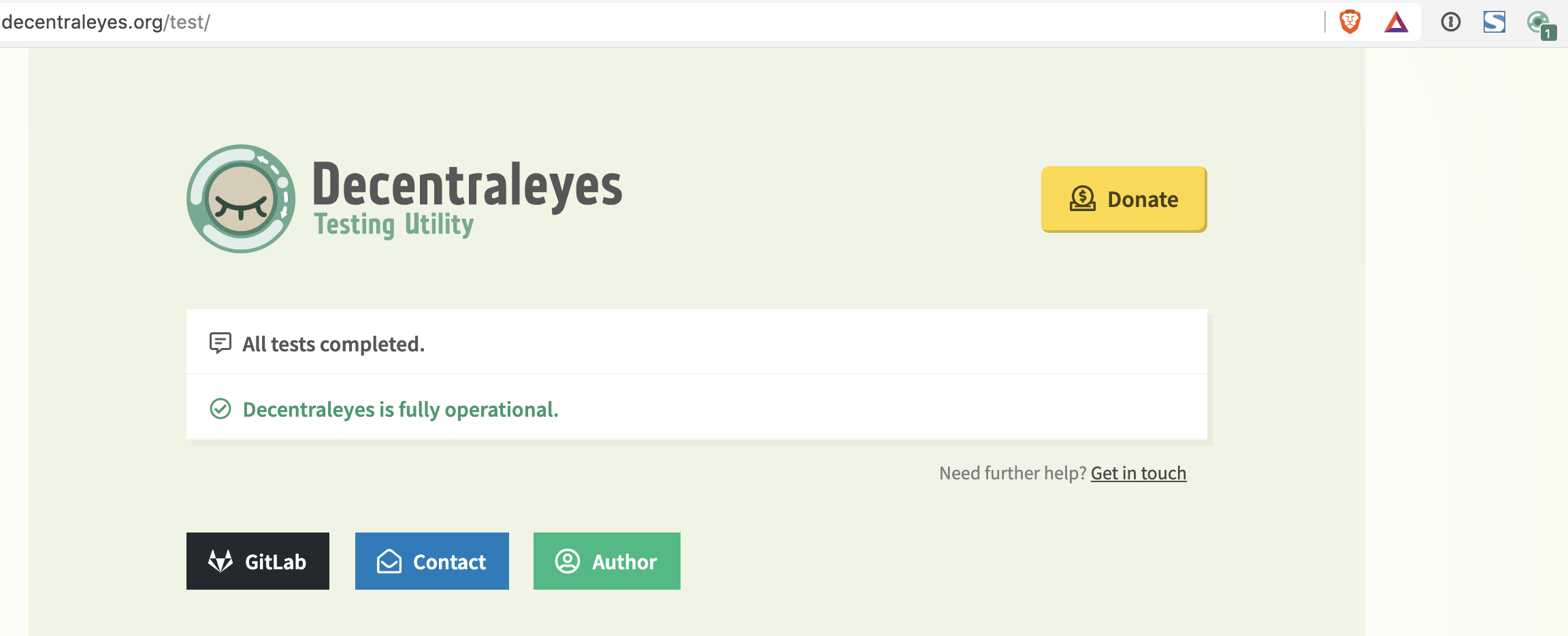

  2. There’s a “test” link at the bottom of the Decentraleyes extension that, when clicked, took me to a page informing me that all tests were complete and the extension was operational:
FWIW, I ran some browser SSL tests and Shields and the extension seem to block the same things with respect to https.

Whether we deselect those options as instructed by Decentraleyes add on, decentraleyes is still working (as you have shown in the picture) but HTTPS Everwhere is sending queries everywhere which defeats the purpose of decentraleyes.
