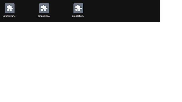

My brave apps icons are now static I can’t move them and greaselion icons started showing up this morning.
Same issue as well using Ubuntu. Greaselion icons appear when launching brave://apps at startup. Icons disappear when I hit F5 or click on a new tab (Shows homepage - brave://apps).

greaselionshow up and remain regardless, does it disappear when refreshed, or what? (If I’m seeing JSan right, it’s a temporary issue and everything appears correct if refreshed?) -

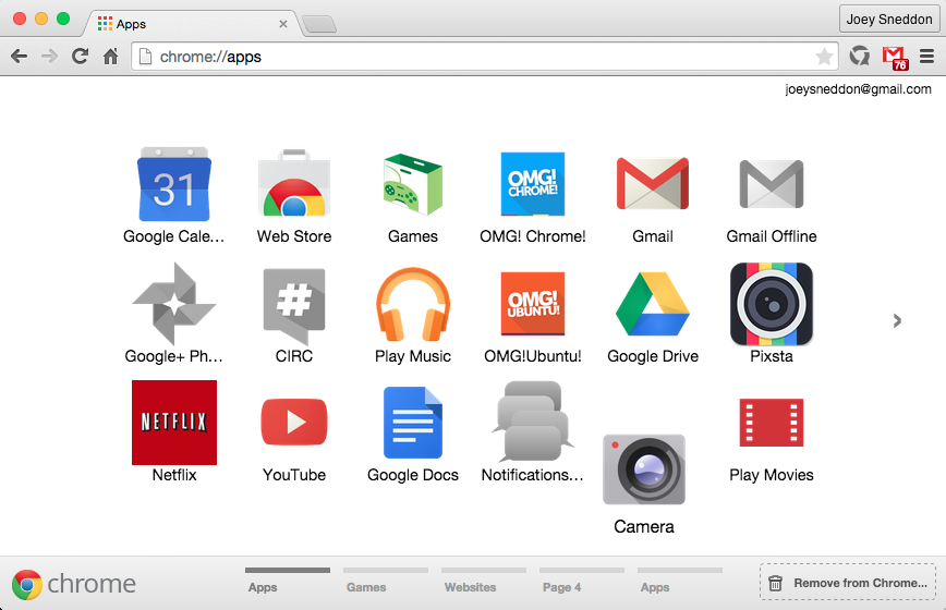

I know exactly what you mean there, and no, I’m not talking about the dashboard. I wish I had taken a screenshot of what the apps page looked like before this change. Maybe I can find a pic on the internet to show you what I mean. I’ll post it if I can find one.
Here you go…

Hi Mattches, My icons are still not the way they were, and I noticed that if I right click and choose inspect, it was sparse on information compared to what it was when it worked correctly. I’m thinking you’ll find your apps page will show correctly for some time before it will “break”. If I left click on the Greaselion icons they will bring me to the Extensions page. I don’t know if that will help you or not. This chrome icon issue for apps when I was using google chrome happend on my Imac, and my wife’s windows 10 computer (she doesn’t use extentions) She also uses google chrome rarely, mostly she uses edge. I think the apps page problem is a chrome issue, not a “Brave” issue. I’m not sure about the Greaselion icons, but they started to show up when the chrome issue with apps page started.

greaselionshow up and remain regardless, does it disappear when refreshed, or what? (If I’m seeing JSan right, it’s a temporary issue and everything appears correct if refreshed?): Based on further tests, greaselion DOES NOT appear when I launch Brave (brave://apps) for the first time after powering up or restarting PC. However, if I close Brave and relaunch (without powering down/on or restarting), greaselion appears in brave://apps. Additionally, greaselion DOES NOT appear when I click the Home Page or New Tab (all pointing to brave://apps) buttons.- Are you noticing this happen with any particular PWA/Site, is it done randomly, or are they appearing in excess to the PWA you have saved there? Of all the apps in my brave://apps site, only ONE is a PWA and that’s Google Calculator (https://calculator.apps.chrome/). Whereas, the rest are created shortcuts under More Tools. Greaselion is only appearing on the brave://apps site.

brave://appson startup? Such as if it’s going to Dashboard or some other site on startup and then go tobrave://apps, does everything work just fine? It only happens if it’s going to brave://apps on startup, if I close Brave and relaunch (see second statement above). If Dashboard or other sites are my default startups, greaselion DOES NOT show up on brave://apps.- Do you have any extensions? If so, can you try removing them or create a new browser profile that you can test this with? This just will help to confirm that’s not an issue with your current profile. (you’ll need to add the PWA to new profile if you choose that method). Only extension I have is Windscribe. Greaselion appears in brave://apps with and wthout Windscribe installed. Greaselion appears in brave://apps when Windscribe is turned on or off. As for using an additional profile, this situation has become a bit more complex. First, having two profiles and choosing one in the ‘Show On Startup’ window, greaselion DOES NOT appears for either profile. If I turn off ‘Show On Startup’, however, greaselion icons appear when I launch Brave for both profiles. Of course, the icons go away when I refresh the brave://apps site.

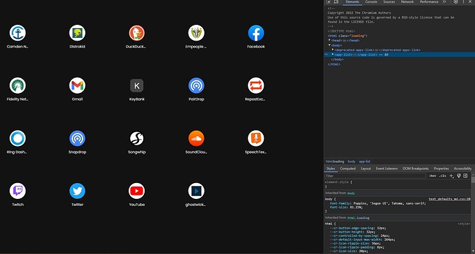

I appreciate you guys trying to fix this for us. Here is a screenshot of my brave://apps page when I inspect it.
As I said before, this used to have a lot more information on it, when it worked correctly. BTW no Greaselion icons showed up this time, while first opening this page.
Please try and capture the console output when the greaselion icons do appear. Further, you are currently showing the Elements tab in the dev tools window — you’ll need to click the Console tab in that window and share that output:
