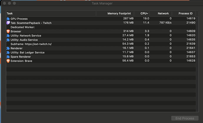

“GPU Process” process is using excessive CPU when just showing TwitchTV page.
  1. Launch Brave
  2. Load Twitch.tv stream
  3. Look at Task Manager
Not using almost all of the CPU, causing system to heat up and fans spin up.
Version 1.19.63 Chromium: 87.0.4280.101 (Official Build) dev (x86_64)
Have tried suggestions from other (closed without help) topics - turned off Hardware Acceleration, disabled #brave-adblock-cosmetic-filtering. CPU Usage remains HIGH.

I have a couple extensions, but they are disabled. So far, it seem to be mostly Twitch, I don’t see such a large CPU usage on Youtube. Here is another screenshot with extensions disabled.

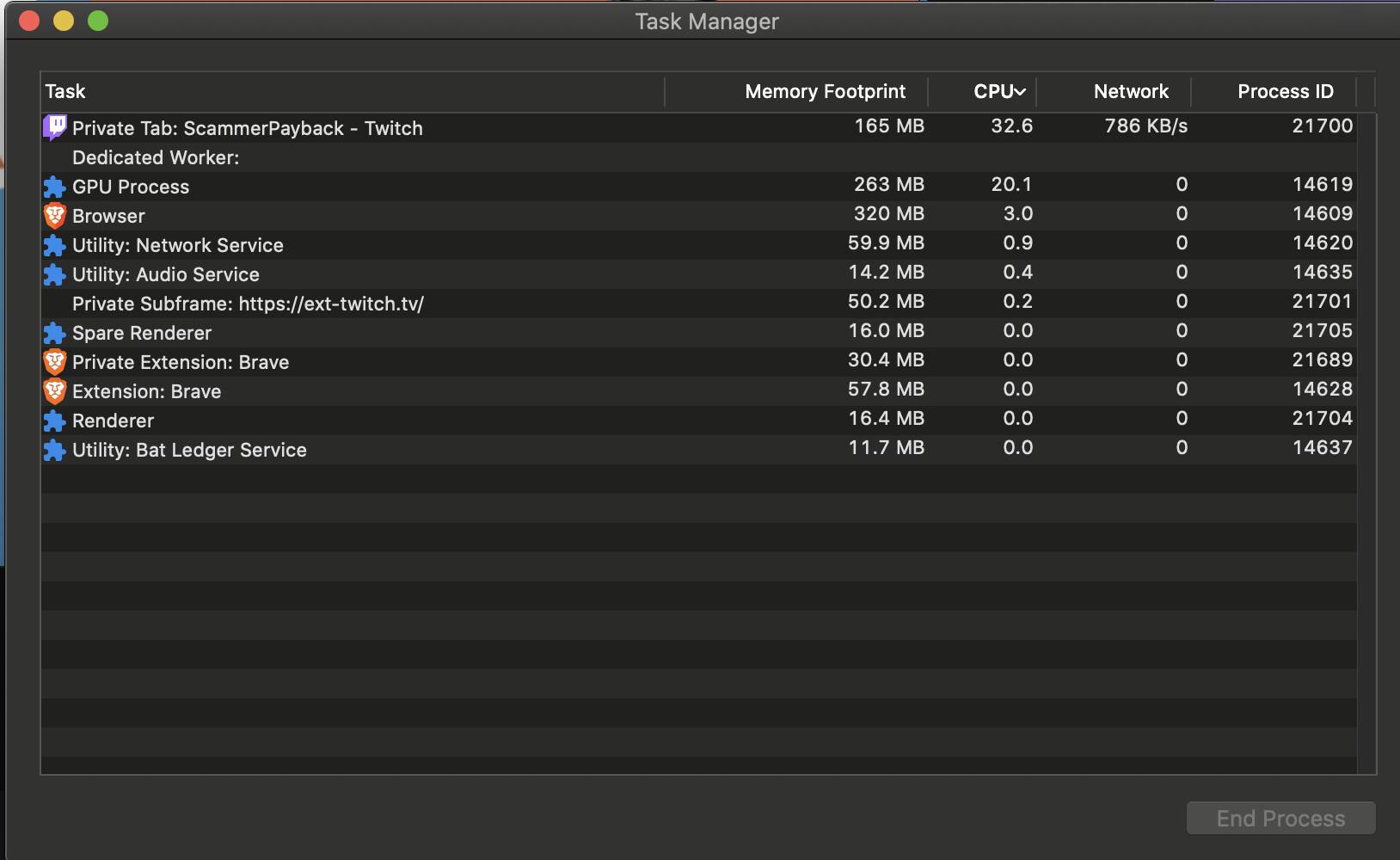

and this when opened in a private window.
