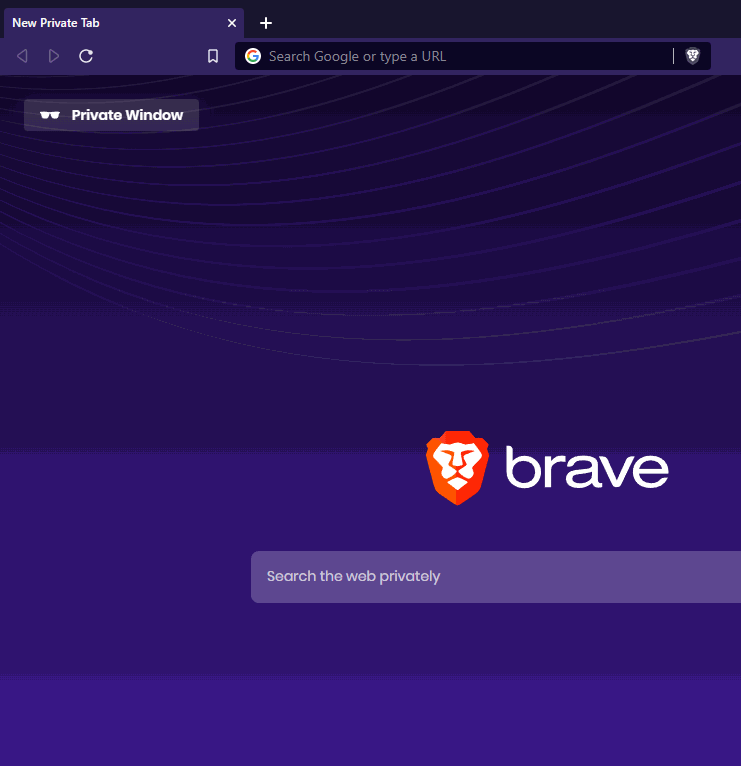

I have been facing a similar issue for a while. Attaching a screen grab where the searches disappear after the page gets loaded.
