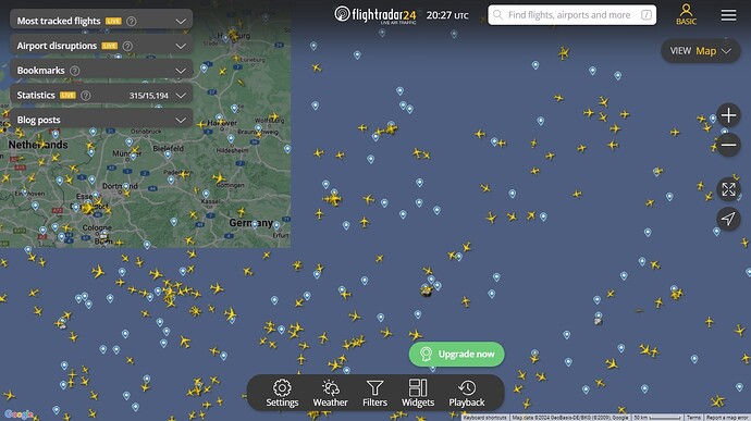

Suddenly it came to flickering when moving mouse and the terrain layer disappears from the map. Before it was working normally without any problems.
I have already contacted their help and they suspect that the reason is in the browser. By the way, this doesn’t happen on Chrome.
Why is this happening? Any solution?

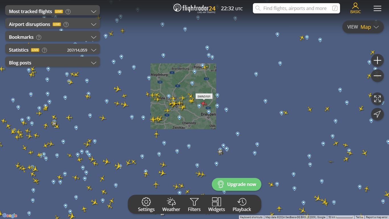

- It happens when the mouse is just pointed on a particular airplane symbol (showing a flight code). The layer squares around suddenly disappear but the one where the pointed plane is located remains.
- it happens the same regardless of on/off the shield
