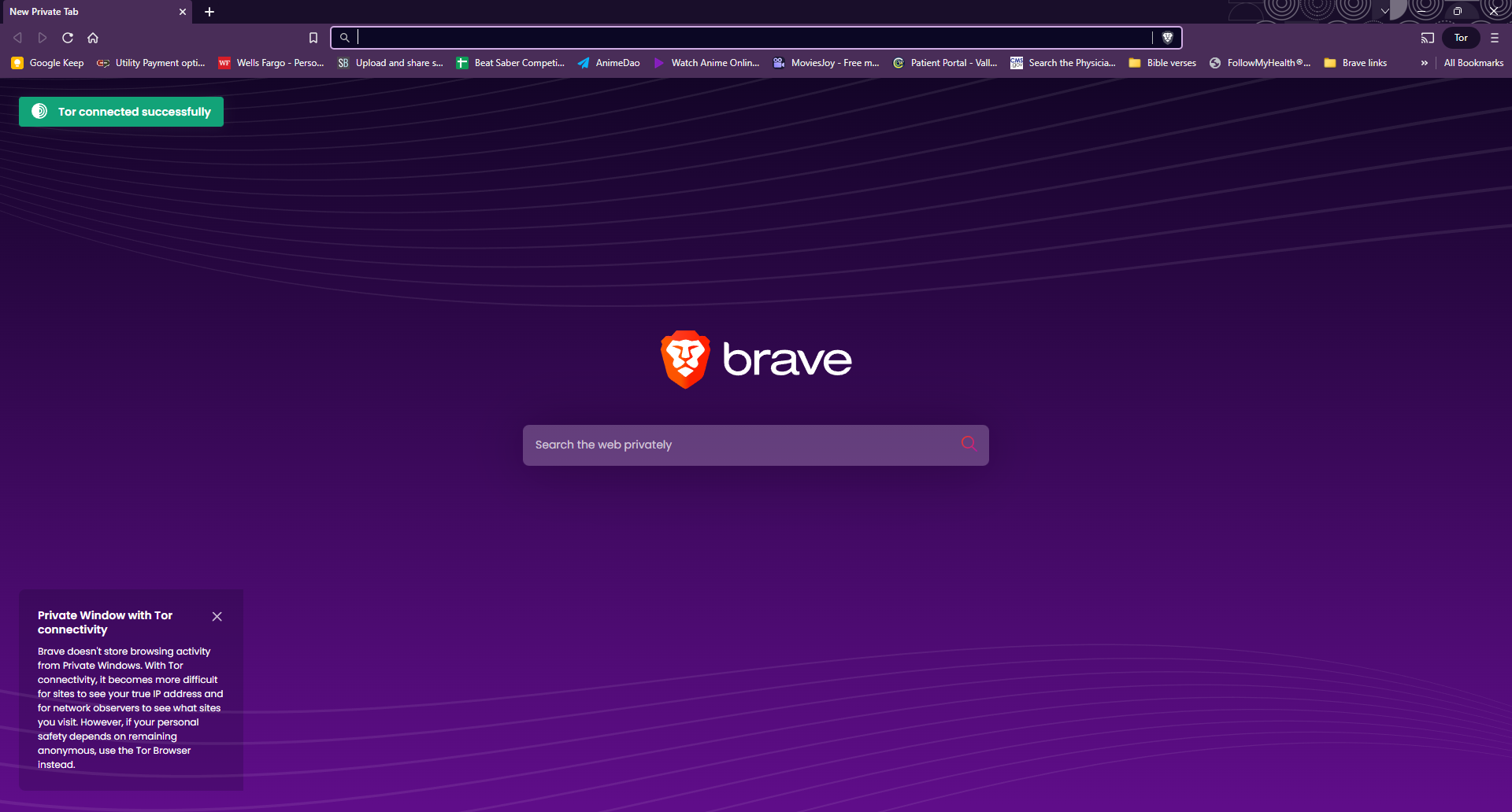

If I make an assumption you’re on Windows, then the answer is I don’t think that you can do it from a quick launch icon. However, you can create a Desktop shortcut that will work. Create a shortcut on your desktop, right mouse click on it, go to Properties, then add a space followed by -tor
at the end of the Target
. Example is below:
May go without saying, but you do need to make sure you have Private with Tor enabled under brave://settings/privacy
. Doing this, when you open Brave using that shortcut, it will open like below:
