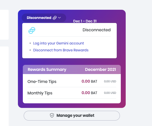

Now I’m stuck in this weird limbo where my Gemini account says that my browser isn’t connected to it, but my browser says that it is verified and connected to Gemini.
Nothing happens when I try to disconnect from the rewards page.

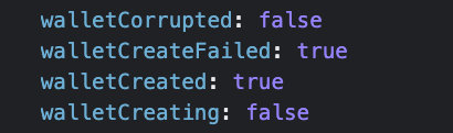

I would guess that maybe this is happening because my wallet “is not created” according to brave://rewards-internals page
That being said:
Brave is showing the remaining rewards that didn’t transfer to Gemini on my attempts
Gemini is showing the rewards that transferred
Not sure what to do at this point – would appreciate some help.

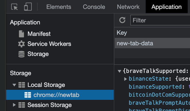

When on the Brave New Tab page, open developer tools in your browser then find Application and/or Local Storage – then it should show some data about the new tab page

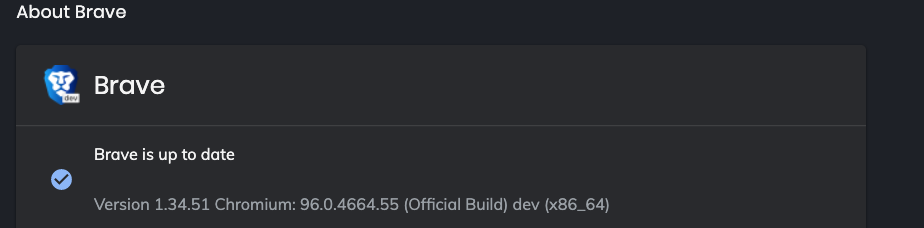

Looks like this is fixed as of build: Version 1.34.58 Chromium: 96.0.4664.93 (Official Build) dev (x86_64)
Finally have the ability to reconnect to Gemini if I want - previously it was stuck as if I was connected to Gemini even though I removed access on Gemini site.
Also able to see wallet info in brave://rewards-internals
