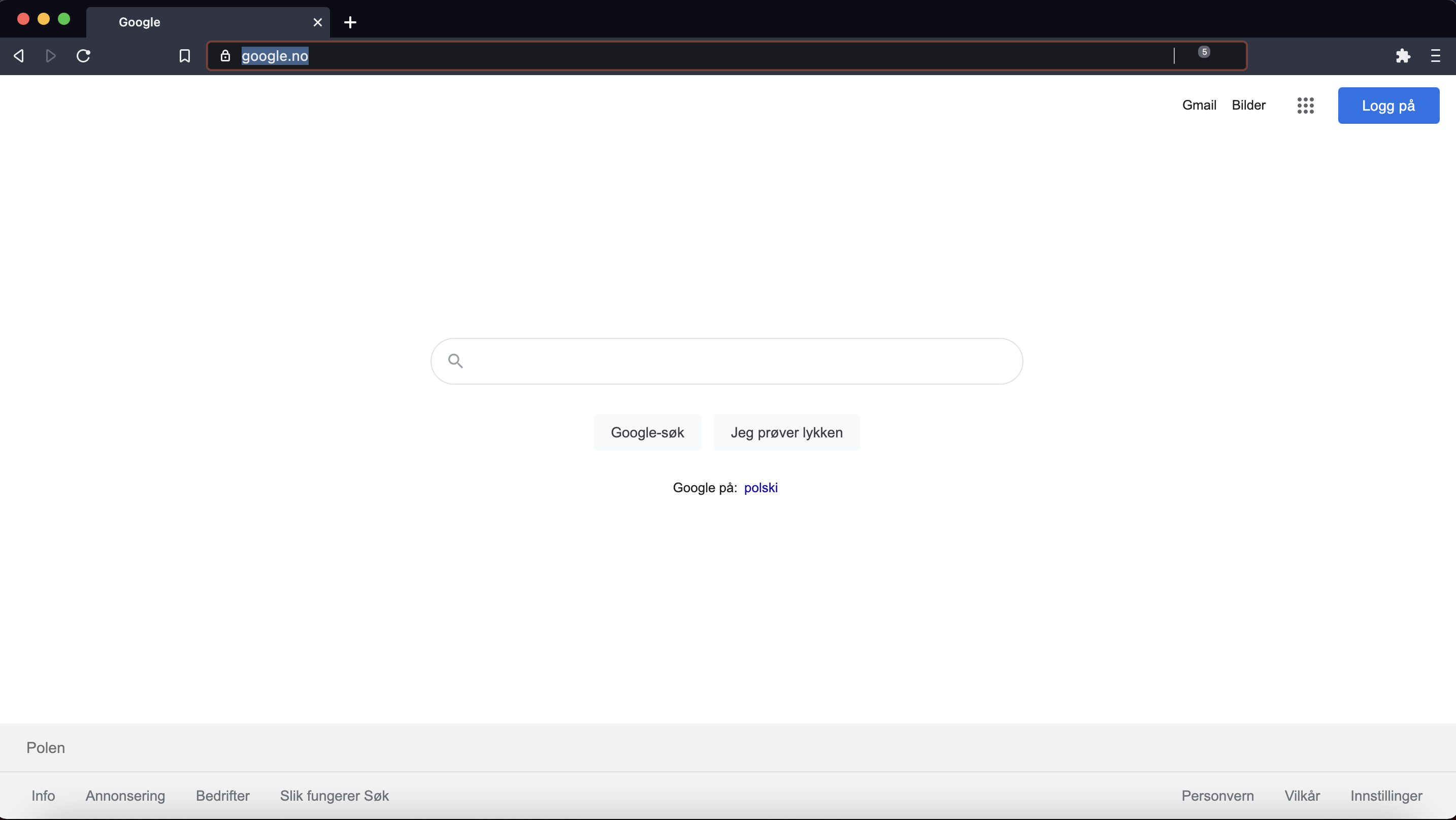

The browser does not load any of the webpages properly. The pictures wont load and when I try to open new tabs, I cant see the other tabs. I have tried to reinstall the app, but it does not work

I tried private mode and to disable all extensions, but it did not work. I use macOS BigSur 11.2.3 M1 chip. Brave version is 1.21.76

Looks like a HWA issue to me.
@sartaj,
Can you try disabling Hardware Acceleration in settings to see if this resolves the issue?
You’ll find this in Settings --> Additional Settings --> System --> Hardware Acceleration
Yes it worked, thank you
