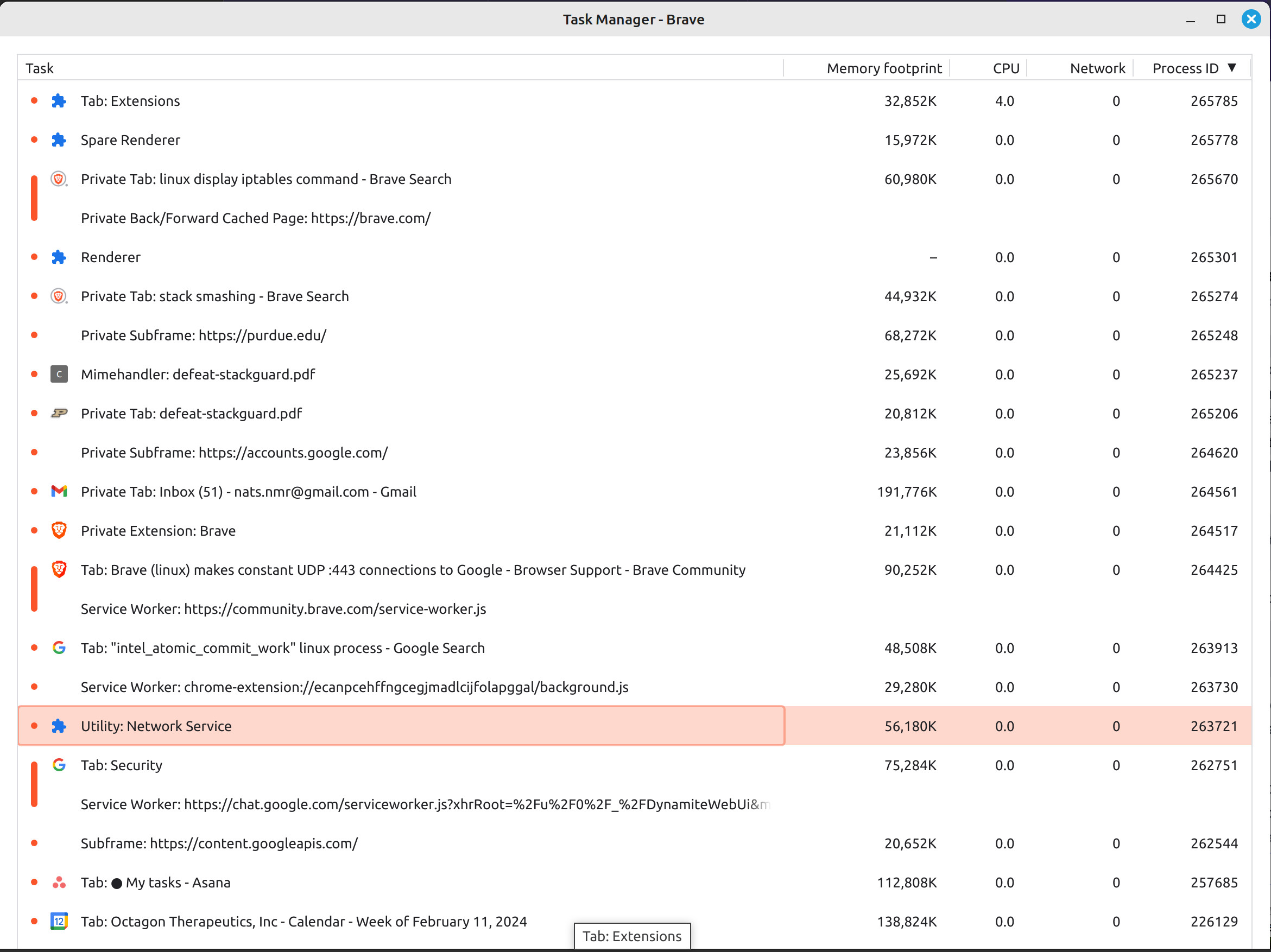

No matter what Brave is or isn’t doing (I can load it on a basic website using only html, no scripts that has a single IP) as long as I am connected to the internet it opens numerous UDP connections on port 443 to either Google data services or, less commonly, AWS. Blocking these IPs with the firewall just causes it to open new ones to other Google registered IPs or less commonly Amazon registered IPs. The overwhelming majority of these IPs are clean and have no history I can find on the net. A very small % of them do have the occasional single report of a phishing scam or the like if I search hard enough, but it is so low those could easily be misreports. Maybe those aren’t actually Google or Amazon so much as those are the hosts of whatever is happening here?
Below are some of the connections at the moment as I write this. The perplexing ones are those udp ones at the bottom (what are those doing?) but all of the tcp ones at the top that don’t also match a udp one at the bottom can be accounted for by normal website activity on Brave at the moment

For the most part Brave is only listening to any one of these IPs, but it has bursts of activity on each one. Here is an example of me applying tcpdump to one of them, it sat there for a number of minutes and then started flopping out the below in rapid succession until I suspended. I was doing nothing on the net at the time, just waiting to see what would happen. That said I did have a large number of sites open in the background so there probably were numerous scripts running, but none of them were on pages that corresponded to this IP address:

Poking around on the net, people have said this looks like the work of the google safe browsing service for Chrome – a service that checks the web-pages one goes to for safety such as via existing reports of nefarious activity. But the data exchanges I am observing via these udp connections are happening even when I am not browsing or doing anything. I can open a static single IP web-page with no scripts or ads, and Brave will exchange information via these udp connections in little bursts with pauses of various lengths in between even after just being left to idle for 12 hours or more.
I guess it is possible that this isn’t Brave but a program pretending to be Brave, but if so it is very convincing.
EDIT 2: I checked “Brave settings” ->“Privacy and Security” the option “Use Google services for push messaging” is indeed off, so that can’t be what is happening. End of EDIT 2:
I have opened and closed brave many times. I have cleared out all the history and started from scratch. I even checked again on a freshly installed linux mint system where I installed brave and opened a new brave window.
Its always. I can’t make it stop. I can’t even block these with firewall without Brave rerouting and establishing new ones. I have even tried multiple range blocks.
