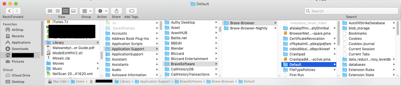

If you want to try the autoupdater (and maybe that’s what’s locking you up?), after your force quit and relaunch try typing brave://help in the address bar of a new tab and hitting return. That should prompt for update if it detects your version is old.
If that doesn’t work or you just want to get the update over with, just download and reinstall. Your stuff should remain intact, but if you want to be careful, make a copy of your profile folder, which, unless you’ve created a new profile, should be
YourHomeDirectory/Library⁩/⁨Application Support⁩/BraveSoftware⁩/Brave-Browser/Default⁩
