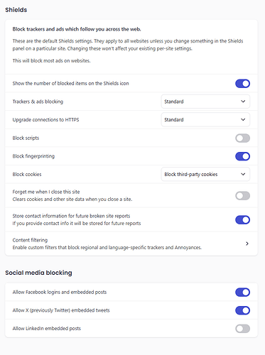

Shield settings for “test” profile left and normal profile right. Also shields were on on test profile, on/off on normal profile.
Shields = If no difference even with it off, this means it’s very unlikely the issue has nothing to do with Shields
Private = This primarily tests cookies and extensions, with the bigger emphasis on cookies. If no change to issue, then usually can rule out one or both.
New Profile = This tests the same as private, but also browser settings.
This kind of narrows down the likely cause of either a setting that was changed or an extension you’re using. Both of these are things that can sync across devices depending on what you selected to sync. I mean, it could be some other corruption in the profile itself, but it’s very rare and unlikely.

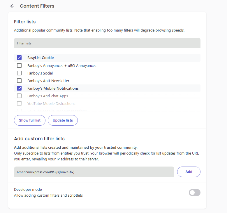

@Nickb1907 this is very strange. I know Fanboynz is from Brave and was trying to help, seeing if they or anyone internally can reproduce. His earlier question, it always goes to https://www.americanexpress.com/en-us/account/password/recover?locked=true when you get the error? It would be good if you can confirm that.

Any changes to brave://flags and in custom content filters are the same across profiles, so it wouldn’t be those. Components should also be shared across and have no role. So I wouldn’t look there.
