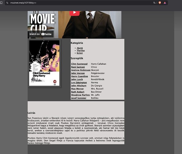

which website is showing the popups?
Under the “link” column click any of the link:
No Links here, but this loaded, no issues with popups I saw
Hi,
Your browser is faulty.
Here is the correct loaded site:
The red mark the links.
Something is wrong on your side.
