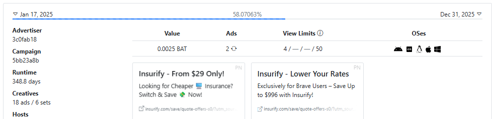

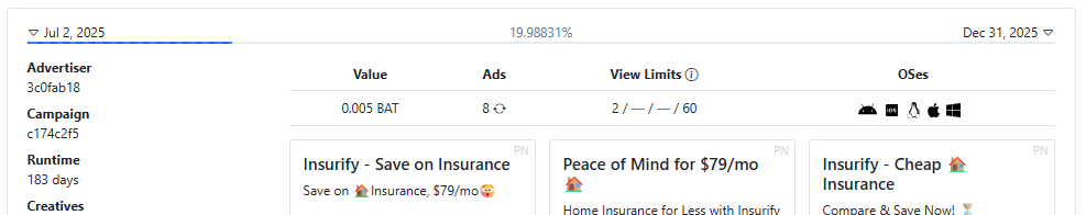

We get 0.005 or so BAT per ad, give or take. You can check out https://sampson.codes/brave/ads/my_region/ to see what’s in your area. But like I see:

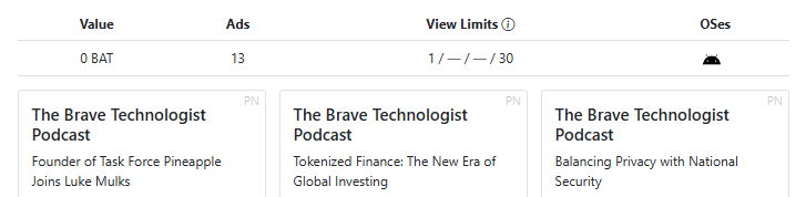

But then remember how I said don’t get paid for House Ads?

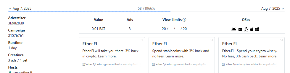

Every once in a while we’ll see some higher paying, such as:
All of my prior reply is to say, not all of your 500+ ads earn anything.
Of those that do earn, it’s maybe 0.005 BAT or so. Though if that’s right, if you did only get 1.27 BAT, then it means they paid you for roughly 254 ads. So the other may have been lower paying for your region or you had a lot of House Ads.

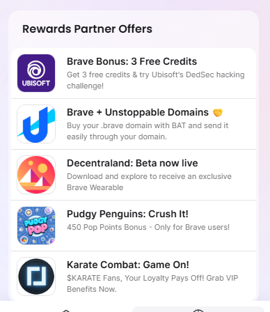

And the big push right now is their new Offer Wall and all, which is basically their Partner Program.
I’m still watching but this seems to be all stuff requiring us to sign up and use partners rather than just earn through Brave. Such as:
