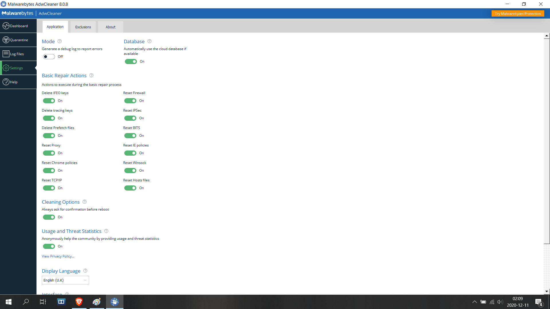

Ive reset system, before that deleted manually everything in previous window in Adware Cleaner.
It was some Advance System Care keys and folder in User/Local/Roaming etc
Plus scheduled task for Smart Game Booster
So after Ive followed with Adware Cleaner …
Ive deleted manually those locations.

Then DvareClean ups exept preinstalled programs with all this settings marked up in Basic Repair Actions.
Without system reset and with folder rename - didn’t helped this time
So decided marking up more settings in Adware Clean up.
After reset is ok again.

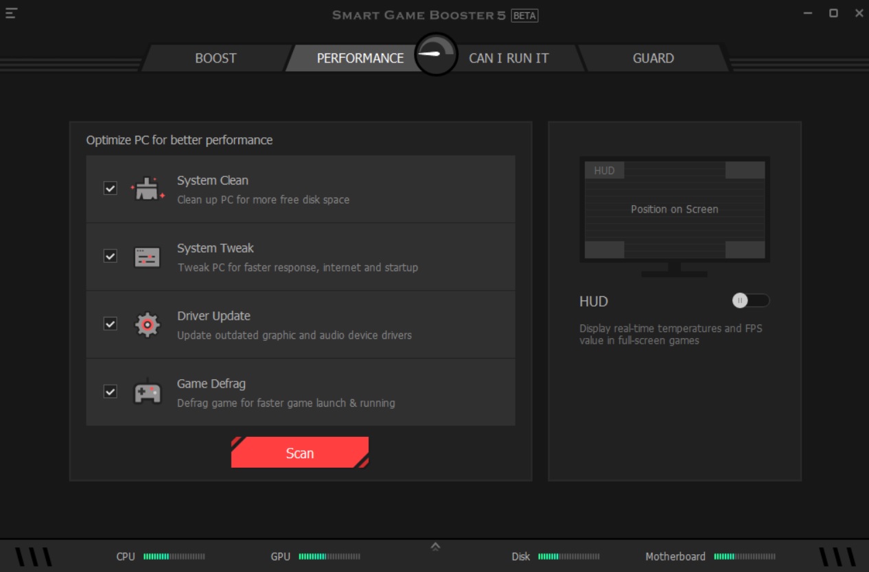

I will have to now force this Thumbnail problem by going to Smart Game Booster and do clean up

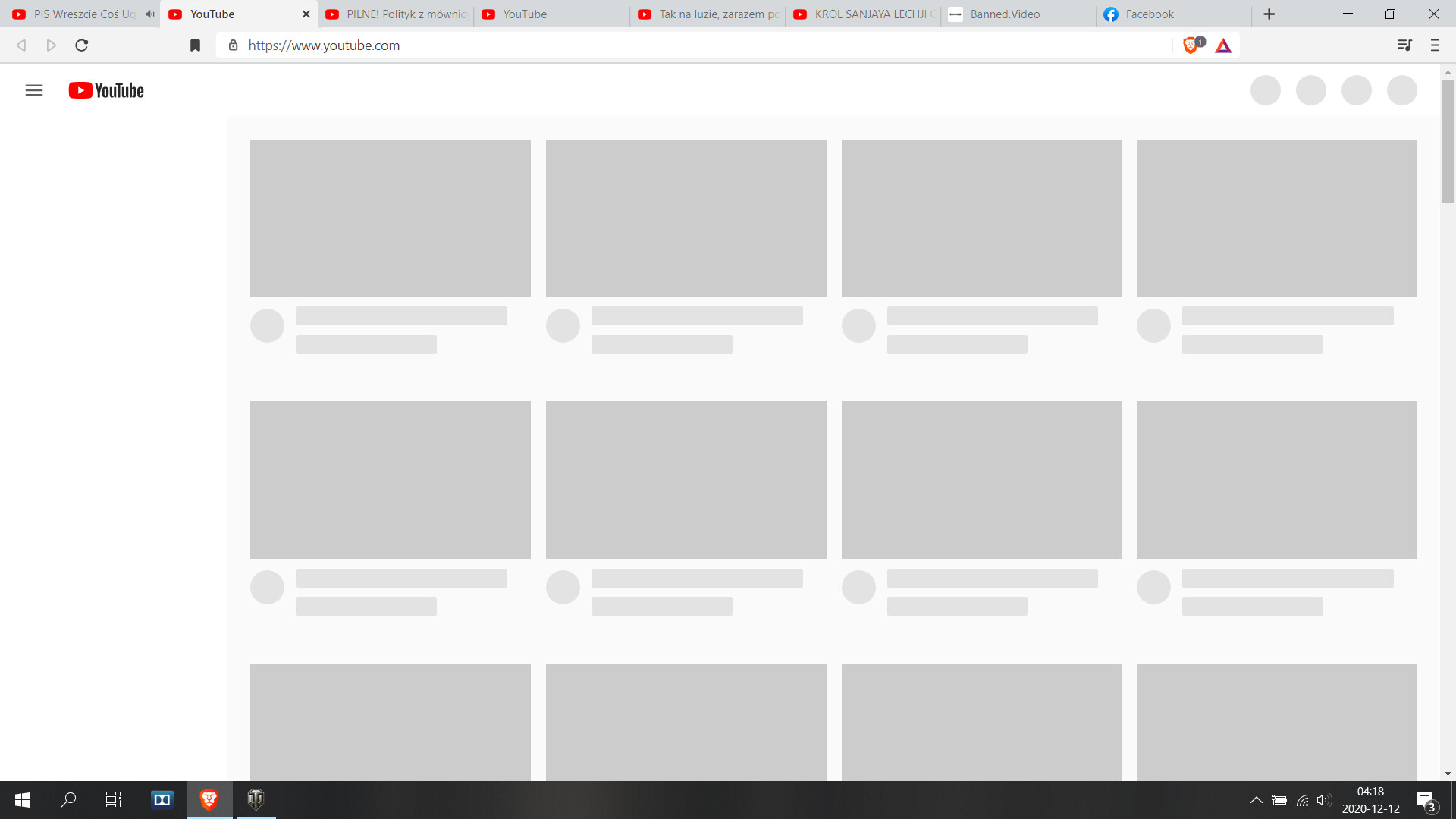

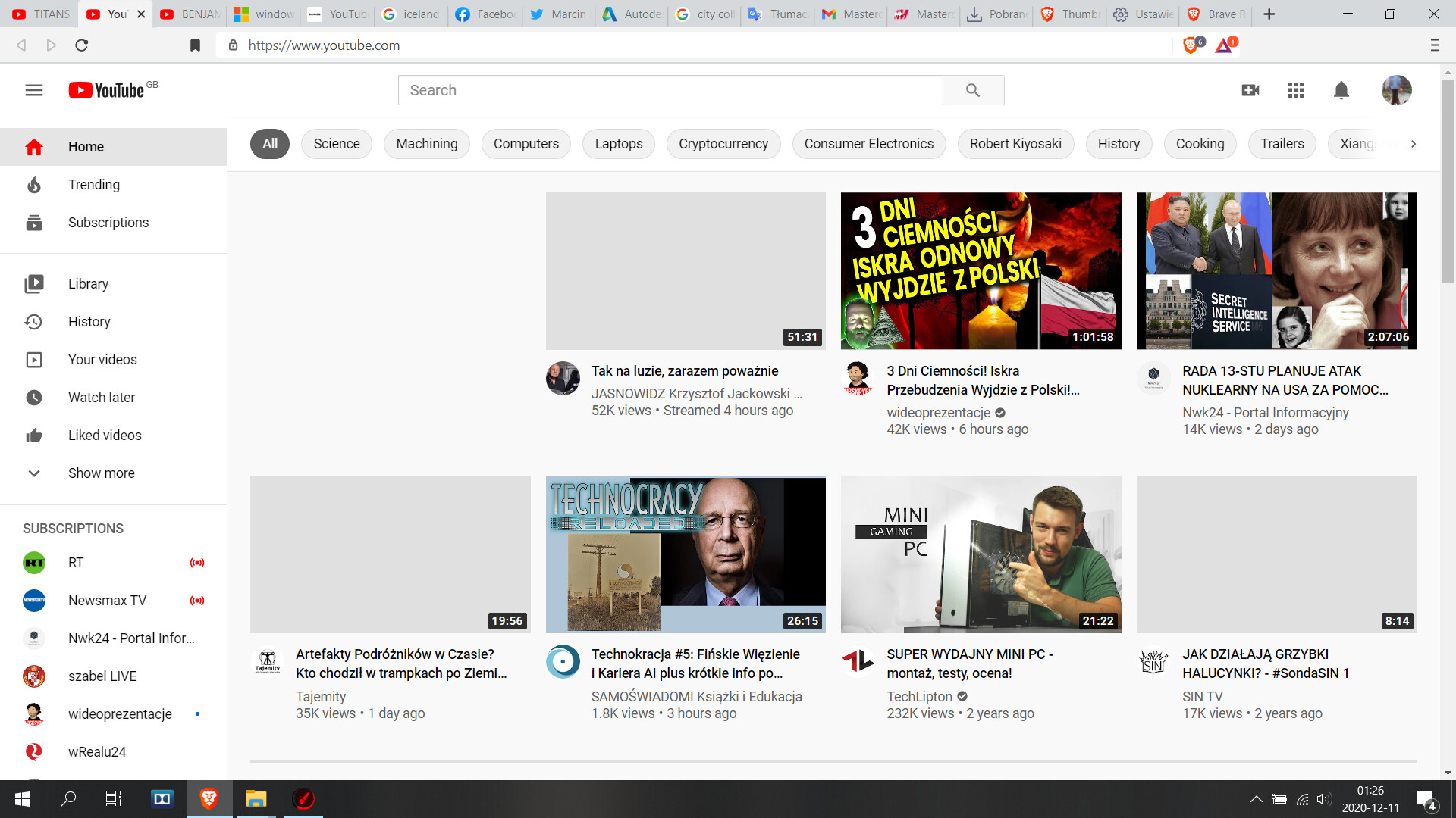

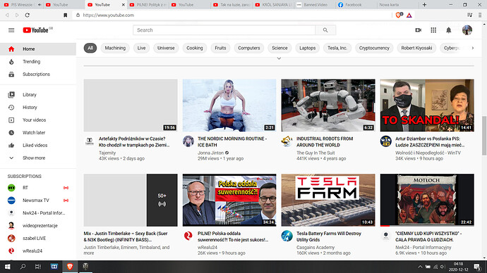

Important !!! All images in my problems are loading up !!! ONLY WHEN I HOOVER WITH ARROW ON THEM.
They are blank but when i hoover on them with Arrow they are coming up.

@Browser Its not only on YouTube but on all websites.

At the moment only Adware Clean resolves this problem with all this reset functions marked up.

after running game with boost of Smart Game Booster
and optimising quick clean up of cash
As ive mentioned any clean up in any program like this affects Thumbnails.

So yes only Adware System Clean solves this problem.
But not completly if ill do any sysytem clean up in any program it will cause Thumbnail problem.
Confirmed
This is last my action after playing game World of Tanks and doing Smart Game Boost.
AdwCleaner
After reset everything is fine but i cannot run any cleaner

AdwCleaner - -quick and easy mark all settings up for resets, and second page preinstalled programs keep them. First page is the mess !!! what i do to keep my program Advance system Care i just keep the file path for it in Program files/ and Program Files x86 2 files rest of it Quarantine or Delete !!!
