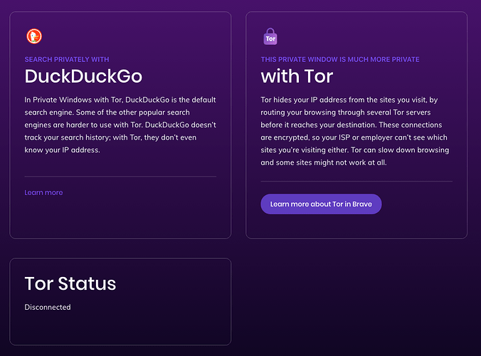

Private with TOR won't work
For anyone here encountering this issue, can you try launching the tor binary from the terminal? You can do this by entering the following command:
cd ~/Library/Application\ Support/BraveSoftware/Brave-Browser/cldoidikboihgcjfkhdeidbpclkineef/1.0.13/
./tor-0.4.4.6-darwin-brave-0
Hi, What do you mean with “from the terminal”
I’ve copied the link; I just got search results like:
  1. How do I set Brave to be my Default Browser? - Brave Help …
  2. Brave Help Center
  3. Desktop Browser - Brave Help Center
    etc.
Please help
@iMaan,
On your mac, open the Terminal application. Then copy the command I provided in my previous reply, paste it into the terminal and hit enter.
I copied the command into the terminal and hit enter. Nothing changed.
Then I restarted my MacBook and checked again; result still the same “Tor-status disconnected”
How can??
Do you have any idea what the problem could be???
Could anybody help me with the TOR window.
It’s still; “Tor-status disconnected” !!!
how to connect again??

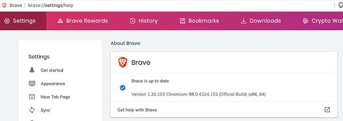

I’ve been experience this fora couple of weeks and c through a couple of updates.
OS X 10.16.7
Version 1.19.92 Chromium: 88.0.4324.152 (Official Build) (x86_64)
I ran the above terminal command:
